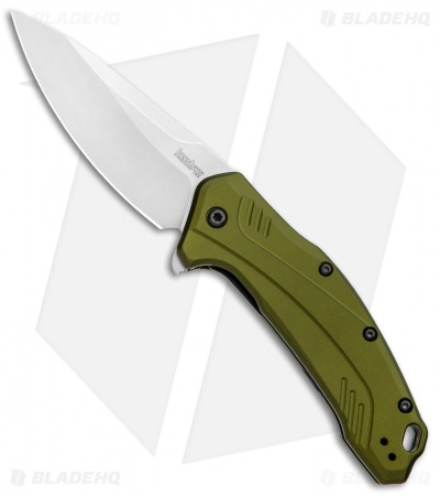

kershaw is releasing a link in 20cv for something like 74 bucks. I hear kershaw heat treats their "super" steels to a slightly lower RC for average users to make it a bit tougher as they know their blades are well used .
This is actually a positive for me as Im about worthless sharpening 20cv , m390 and all those more rugged stainless steels. So I might pick a link up in that 20cv . Ill have to buy a diamond stone either way though for that bad larry !
EDIT : Looks like its already out ! https://www.bladehq.com/item--Kershaw-Link-Drop-Point-Knife-Olive--105987
Let us know how it is once you've gotten and used it. I like the handle color
I have a Link with FRN scales and one with aluminum scales. I tend to prefer the FRN scales for the slightly better grip it affords. The smooth aluminum on the Link almost feels slippery to me. I also rarely carry an assisted open knife.
The new 20CV Link mentioned above has aluminum scales but unlike the other aluminium Links, there's a little bit of milling to provide grip. That, and being a little cheaper, would make it the "super-steel" winner among the Links.
