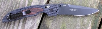

Call me silly, call me irresponsible, but I felt like jumping for one of these...
But I agree I would REALLY like one with PE, 154CM or S30, and BLACK aluminum handles. But, we do what we do...
