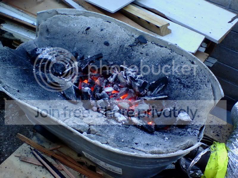

That is a fantastic DVD. His forge design works great and is CHEAP. Here is mine. Used it to make the two unfinished knives in my previous post.
Things have progressed slower than I thought, when I got the video....
But, I have my blower, my forge body, a rail anvil, 2 post vises and I should be up and running early Nov or shortly there-after. I got my blower and the better of the two post vises by barter for a knife to be forthcoming.
Very inexpensive way to begin. I think I have 40 dollars into it. The rest has been scrounged. And I owe a guy a knife once I am up and running. But, the same guy is also buying at least one knife, once I get going.
