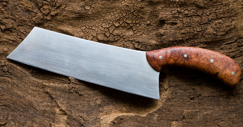

You may want to consider giving your blade a hand-rubbed satin finish. It takes very little equipment (sandpaper, clamps, and a stick), and looks good. You can leave the finish relatively coarse if you don't want it to look too shiny. Here's an example of a blade I left coarse:
