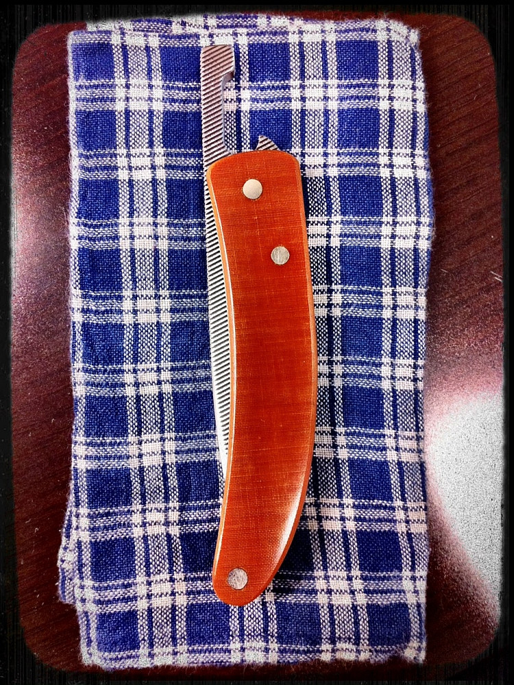

there are custom makers who work in carbon steels who won't exactly break the bank. they are usually more traditional, but these Michael Morris friction folders can be operated with one hand and are sexy to boot. (made from old files, so they might be considered tool steel, not simple carbon?)

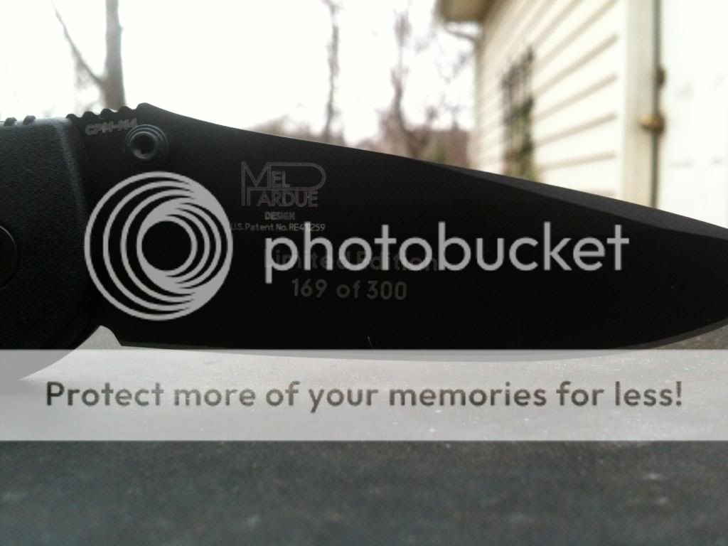

Kershaw uses CPM-D2 on some of their composite blade knives. Also, the Alabama Damascus they use is made of carbon steels. Spyderco uses CPM-M4 on various models. I think the Opinel cabon steel knives use 1095, if you were looking for that steel specifically.
I would like a fully modern locking knife in a carbon steel like 1095, I'm talking one-handed opening... I just like the character carbon blades can develop, you don't really get that with stainless.
It's LE, but still

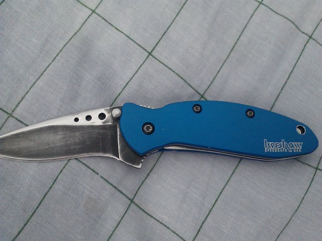

And IIRC the Scallion is 420HC
420hc is stainless.
