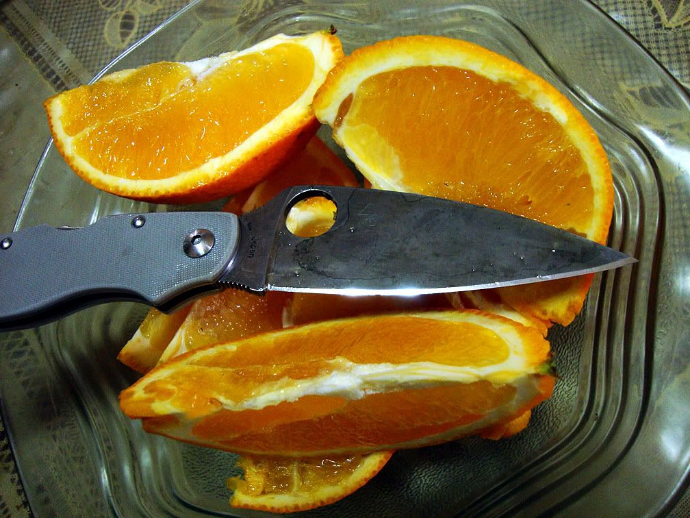

Aogami Super Blue would fall into the "Low Alloy steel" category.
It has less than 10% alloying elements.
It might not "technically" be carbon steel, but it seems to be able to take a patina easily and have the properties I like, so I'd still be quite happy enough with a folder in it. :thumbup:
