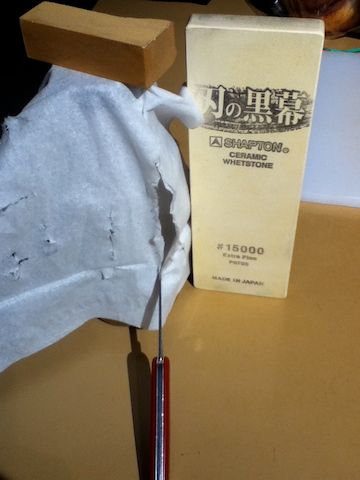

I've noticed that knives that can cleanly slice slivers from a sheet of regular copy paper and that generally seem pretty sharp will fail miserably if you unfold a napkin to a single sheet, pierce the napkin and pull the knife down. It mostly just tears it.
Not that slicing napkins is an important use of my knives, but I was just wondering if there is something special about how to sharpen an edge (for example, maybe only highly polished edges work well?) so that it slices napkins (and other similar materials like paper towels) cleanly?

Well this is what I did for a quick try :
Super shallow angle sharpening bevel I don’t have a good way to measure it but it isn’t much steeper than the blade grind of this SAK Bantam. Probably six or seven degrees per side but that is a guess.
Does any one know that the main blade grind is on a similar SAK ?
The edge was already scary sharp but I took it to the 8000 grit Norton water stone (USA version; don’t count on the new Mexico Nortons to be as good I know they have problems)
Then onto the Shapton 15,000 (I used the other side of the stone but this one is more photogenic).
and you guys will be happy to hear I free handed it. And they said 'Bagger couldn't do that.
No stropping
I was carving curls off hairs that were still in my arm like crazy.
I didn’t want to cut up one of The Chef’s nice cocktail napkins so I went after one of her Puffs Plus Lotion facial tissues.
I wasn’t able to push cut once I pierced the tissue but moving slowly with just a slight slicing motion I was able to get a decent cut going.
My real test isn’t paper or tissue but my finger nail. If I can take off a bit of a curl rather than tiny chips then I have created a decent cutting edge. See second photo. After this one I was able to take a curl about 10mm long (yes I used a ruler) and that was push cutting. Try that some time; careful you don’t take off a bunch of skin while you are focusing on the nail.
Now I suppose if a guy wanted to bussssout a strop it could be a little better. I think at this stage it is edge geometry over a higher polish though.
Any reasonably thin edge <30° with a thin primary grind behind it should do this at almost any finish level. To unfold it and and shear cut it like a freehanging sheet of paper you'll be best off with something in the medium finish range, though again as long as its done well even a bright finish should pull it off.
This is one on my standard tests.
Agreed, it doesn't have to be so thin. A 15* edge finished on a 400 grit stone and stropped will slice a napkin. For a tissue finish finer. DM

its a "tricK" a way to demonstrate a some level of sharpness, like head hair whittling is to show a high level of sharpness
Its also tricky because lots of little changes can affect if its possible to perform
For example in miso2's video,
it shows very high sharpness,
but how to compare it?
- paper looks thin and very bendy , not thicker like charmin (+difficulty)
- looks and sounds more like cocktail napkin or paper towel than toilet paper (-difficulty)
- cutting going cross grain (+difficulty)
- seems to pull the paper is kind of tight (-difficulty)
- cutting at an angle (45?) due to shape of blade (-difficulty)
- speed is not super slow ( -difficulty )
- speed is not super fast ( +difficulty )
- edges of the cut paper are very smooth (+difficulty)
so his is a very sharp blade
with edge polished to a very high grit
but change the way you cut and you can do it with much much coarser grits

Just for clarification. My edge is not highly polished.
I stop at #600 stone, of which grit size is supposed to be 10 micron according to the Grand Unified Grit Chart, and lightly deburr with a #1,000 ceramic rod, which should be around 5 micron. The stropping compound I use is rated as 3 micron grit (#4,000 Shapton equivalent).
So the edge stays toothy to some extent and is refined enough to cut soft materials clean. I just like this kind of edges even though coarser edges may serve me better.
Obviously, this test is not really necessary either. I just use it to test whether the edge is refined enough without remaining burrs or edge inconsistency. I found it useful when sharpening steels with high vanadium contents, which are difficult to refine (for me), and learned that I need diamond abrasives for those steels through this test.

You need a keen but aggressive toothy edge cleanly debured. Low edge angle preferably < 20dps at apex. the edge should pass the 3 finger test and grab your thumbnail both across AND ALONG the the edge. It should slice paper towels, toilet paper and tissue paper
The way I accomplish this keen but highly aggressive edge is to use fine grit silicon carbide abrasive paper. 1200-2000 grit. Instead of using a mouse pad I use a rod of any hard material. Steel rod or wd40 can or a thick marker pen. wrap the abrasive paper around it tightly then use sharpening strokes on it as you would on a sharpmaker rod. The 1200 grit will be a little coarse at first but break down nicely after use and offer more refinement. You can use both edge leading and stropping motion to quickly establish the apex. I finish with alternating very light edge leading strokes. The sharp silicon carbide abrasive create a notably more biting edge than off stones. It should bit hard on soft napkin material yet should be refined enough to sail through thin magazine paper with a whisper quiet hiss.
I might add that such edges aren't entirely useless or just for show. In rare cases it may offer some advantage to the usual highly stropped edge. I like this edge for slicing steak and meats. It cuts them nice and clean with little effort. But beware this edge is highly dangerous to skin!
