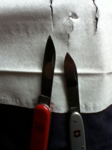

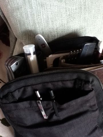

I pulled the silver SAK out of the man purse.
It had been sharpened before Christmas on the Edge Pro to 4000 edge trailing. I don’t remember using it since I sharpened it.
Man purse ? Well you know . . . just the essentials : CS Ti Lite VI Razel, Spyderco ultra fine sharpening rod, fork, comb, back up pens, emergency sharpening kit, ruler. . . . there’s a marlin spike in there, drawing implements of construction. Just the essentials.
I took a few more passes on the Shapton 15,000 stone with the red SAK edge leading to really feel the stone. Usually I “strop” with a few edge trailing but did not do that this time.
First I hair whittled with both knives. The Edge pro sharpened silver knife whittled a little easier and more controllably as if to say “What thickness curl do you want here ?“.
The hand sharpened red knife whittled but requited a little palm stropping like six strokes total to really get the edge to whittle on BOTH sides of the edge evenly and then it struggled here and there and was not as controllable as the Edge Pro sharpened edge even at only 4000.
Do you see why I prefer a . . .oh my gosh “jig sharpened” edge?
Interestingly enough the red knife still did better at the Puffs tissue slicing. See slit and knife on the left. That knife is shallower angle than the silver knife on the right by a degree or so per side.
Again . . . : the silver knife on the right was better at whittling but was sharpened on 40000 shapton edge pro where as the better slice was shallower and done on the Shapton 15,000 yet was less great at whittling hair.
:confused: I don't know . . . I'm just reporting the facts mam.

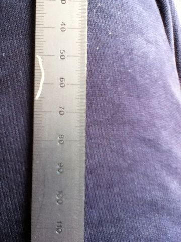

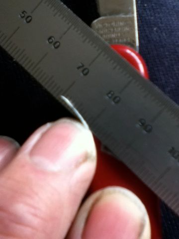

Now for the “practical” use of such an edge AND the edges were still able to whittle hair after such a grueling test of the edges (trimming finger nail).
I uploaded the above photo to photo bucket and then decided to go back and continue the same curl / cut trying for a longer cut so I continued cutting the same curl and went all the way across my nail to just before the curl would come off. Very controllable cutting . . . yes ? This wasn’t the entire width of my finger nail but that was definitely in the realm of possibility. Usually I just take a few millimeters of a curl and I can tell if the edge is “there” or not. Pretty much with the Edge Pro all I have to do is go through the motions . . . habit . . . of going from one stone to the next a few strokes [not twenty or fifty or a hundred per side like stropping] like six per stone for three or four stones and the edge . . . after the 40000 is ALWAYS as sharp as the little SAK as it came out of my bag today. What I am saying is : with hand sharpening I need the fingernail or tissue test. With the Edge Pro I don’t even need to test the edge to know when I am THERE.
Stil . . . I admit these edges could be better . . . NO DOUBT about that . . . but you asked for a formula and I didn't spend much time at all on either of these knives. I mean the passes on the 15,000 was just about six trips part way down the stone on each side total alternating. Super light pressure. (the edge was sharp already I just gave it a little Umph)

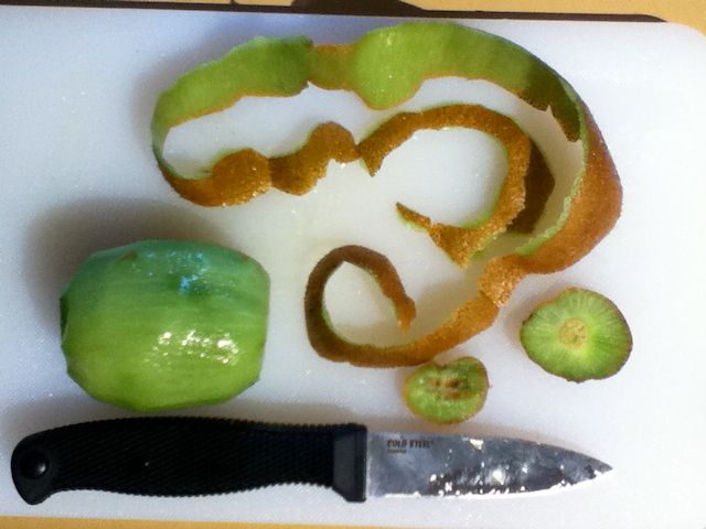

Here is another reason for such an edge geometry and level of sharp.
Push cutting of course.
All in one piece. A flawless kill.
Do you really want to pass up a chance to take such a fine trophy to display on your bulkheads ?
Be Kiwi capable.
PS: besides having a fine pelt they are good eating ! ! !
