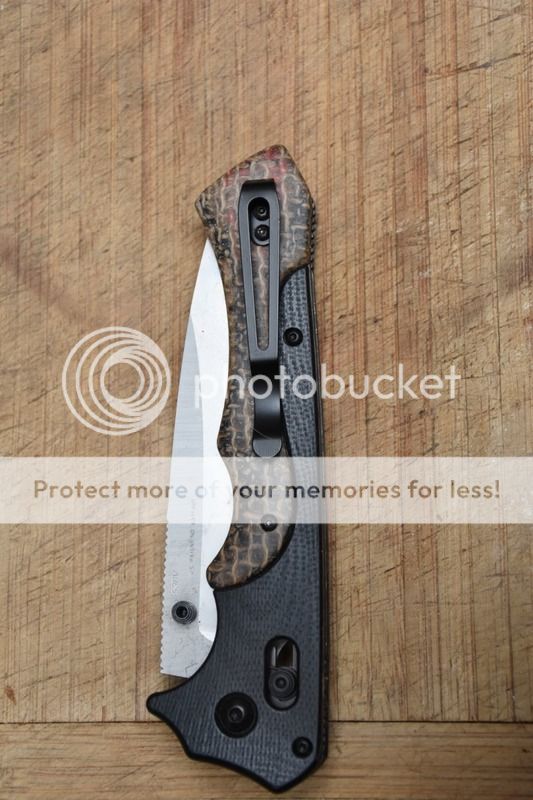

I did ask a knife maker if he could design a stiffer clip. I think the problem is the long groove cut into the clip to provide access to the mounting screws, making the key part of the clip two long, thin strips rather than one wide solid clip. That groove doesn't have to be that long. Or maybe just a thicker gage steel/ti would work. Or maybe a stiffening filler piece could be installed.
[EDIT: No luck. Seems that this clip has stumped many.]
Still love this knife. Here's one of my unused Rukuses that shows the clip.
I replaced mine w/ a Bradley Mayhem clip (believe BM has another model that uses the same clip). Screws don't line up 100% so there's only one holding it, but it does fit the milled part of the handle. It's way more secure than the standard clip.
