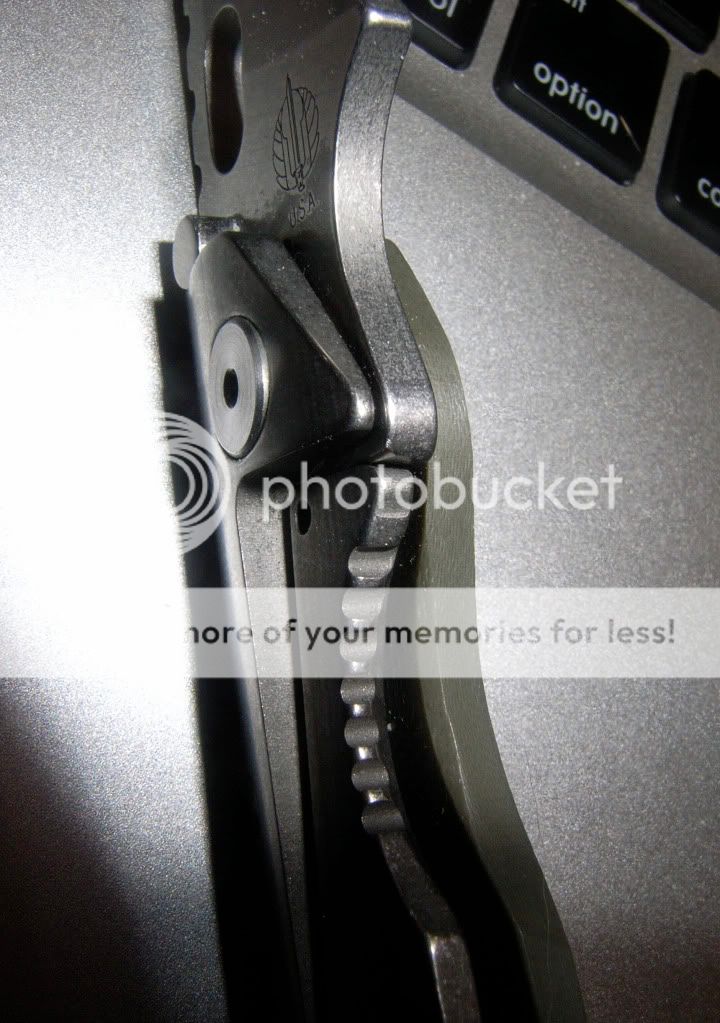

Hey guys, i've carried a strider pt in my front pocket for 2 years now, and over time the lock bar has managed to move past center
to where it's almost 100% under the tang - like +97% covered (i can post a pic later). When i use the knife and squeeze the handle,
i can sometimes hear the bar squeak as it's gives a bit under the pressure. What does this mean?
Is my PT terminal?
Sniffle sniffle.
-Popo

The squeaking is probably the lock bar moving over slightly more. This will happen with many integal locks.BTW the squeaking from too much pressure will speed up the process of the lockbar moving over. Its scraping against the back of the tang which is a much harder metal. Guess which metal will wear out first? It would be the softer titanium lockbar I think people worry too much about lock bar travel when it gets over 50-75%. I've heard people mention their Sebenza lockbar was almost 100% or even a hair away from touching the opposite handle. They have used their Sebenza for yrs after this happened. I would start to be concerned when the blade sarted to get some play.

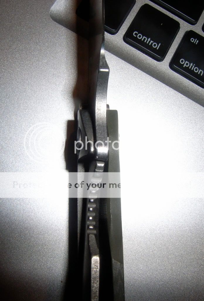

Now that i'm home and holding the knife i realize that there is a bit of virtical blade play. :( Apparently the bar isn't bent enough to fill the space - i can push the bar in a touch and the play goes away. Wonder if i can bend the bar myself? (maybe i'll take some advise and send it in).
Do not try to remove the stop pin/thumbstud yourself. Send it to them and they will put a cap on the Ti side thumbstud and make the diameter bigger so that it comes into contact sooner. Something to try. Take a small thin piece of clear tape and wrap the Ti side of the thumbstud a couple of times. Then open it up and check out the lockup. It doesn't take much to improve lockup. Sounds stupid, but it's a quick and easy fix. And you won't even be able to see the tape.

DO NOT BEND THE LOCK BAR. That is not your problem. Your problem is that the lockbar is too short or has been worn too far. Just try this, it takes 2 seconds. Take a piece of paper and fold it in half. So you have the thickness of 2 pieces. Then hold it over the Ti side where where the stop pin contacts the scale. Open the knife up, so that the piece of paper gets stuck inbetween the pin and the scale. Look to see if the lockup position doesn't improve
Yes Socom, when i do this, the lockbar overlaps only 25%. Perfect.
