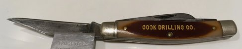

I found an old, Old Timer 34OT knife at an antique store and I'm in the process of sharpening the blades. All of the springs are pretty limp, to the point where I don't feel safe doing anything with it except cuts that push the blade open. Is there a way to restore some stiffness to the springs? Would freezing the knife do anything? Any advice is welcome.

Providing the tangs and springs aren't worn down, you can bend the springs a bit to gain more flex. This requires taking the knife apart, and there's no guarantee that the springs won't break in the process. It doesn't make a huge difference, but it definitely works more times than not.

You may find that the springs are fine, but the tangs on the blades are so worn down that they are the reason for the weak snap. Regardless, as others have said, this particular knife is not really worth putting any money into to restore. The construction of the knife makes it hard to simply do blade or spring swaps.

On close examination of the springs and blades, I think this might be the problem more so than the spring stiffness. The ends of the springs drop below (meaning farther inside) the surface of the knife spine, both when the blades are fully open and when they are fully closed. It's almost as if there is material missing from the blade tangs, allowing the ends fo the springs to move farther inside the knife handle. I had put this down to poor fit and finish, but the blade pivots definitely show the "black steel dust" that Obsessed with Edges described.
Here's the knife in question, by the way. It's kind of interesting in that it has "Cook Drilling Co." printed in yellow on the back side. Clearly it was a corporate gift of some sort, which makes sense given that I found it in Wichita Falls, Texas (oil country).
