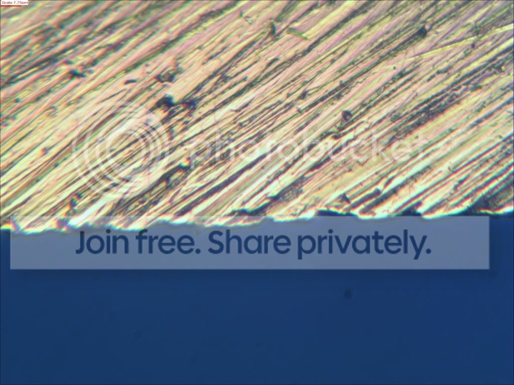

This edge came off of an 800 grit King stone and stropped on newspaper. It could just treetop a few leghairs, and dryshave the stubble on my cheek (tho it did itch a bit after). This is the kind of edge that can cut rope all day long. Definitely sharp enough.
This edge on the other hand, came off of a Spyderco EF stone and was stropped on leather w/ Flexcut Gold and then plain leather. Hair whittling, but not for long if it starts getting used for much.
Both pics are at 640x (scale in upper left is 7.7mu)
Whatever grit your edge is ground to, it can still be finished off well enough to be considered "sharp enough". I agree with the statement that one's judge of what is sharp changes as one gets better at the craft. But I recently came across one of my old work knives (I used to grind them to 80-120 grit a few years ago when they saw daily hard use) and was curious if it was as sharp as I remembered. It easily parted free-hanging denim from an old pair of jeans, and could pushcut newspaper with the grain - needed a little draw to cut across the grain. Plenty sharp enough even if it could barely shave arm hair, and it can do hard work exponentially longer than its hair-whittling brethren.
