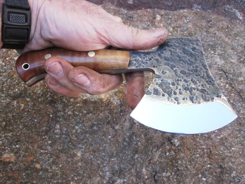

Since I've been making hatchets (about 20) for about a year now I'll throw in an idea... if you intend to choke up on it and use it like a knife, it needs a sort of comfy handle all the way up. That means no thin sections, like on most hatchets cut from plate, and no overly wide sections, like on traditional wood handled hatchets. Learned this while making my first bow-drill fires, making all parts with my hatchet, and slicing my steak, and making a spoon, and a bowl....

we'll see how this works out
When I was young, we had knives that came with interchangeable hatchet blades. It was a leather sheath that held a regular knife and a hatchet blade in a pouch behind it. You pulled down a lever on the butt of the knife to takedown the blade and then inserted the hatchet and snapped the lever back down. Haven't seen one in quite some time, but if I were asked to make a skinning hatchet, I think that's what I'd do.
