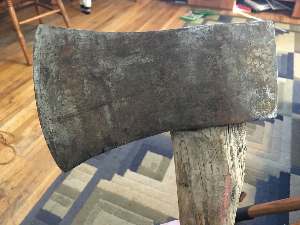

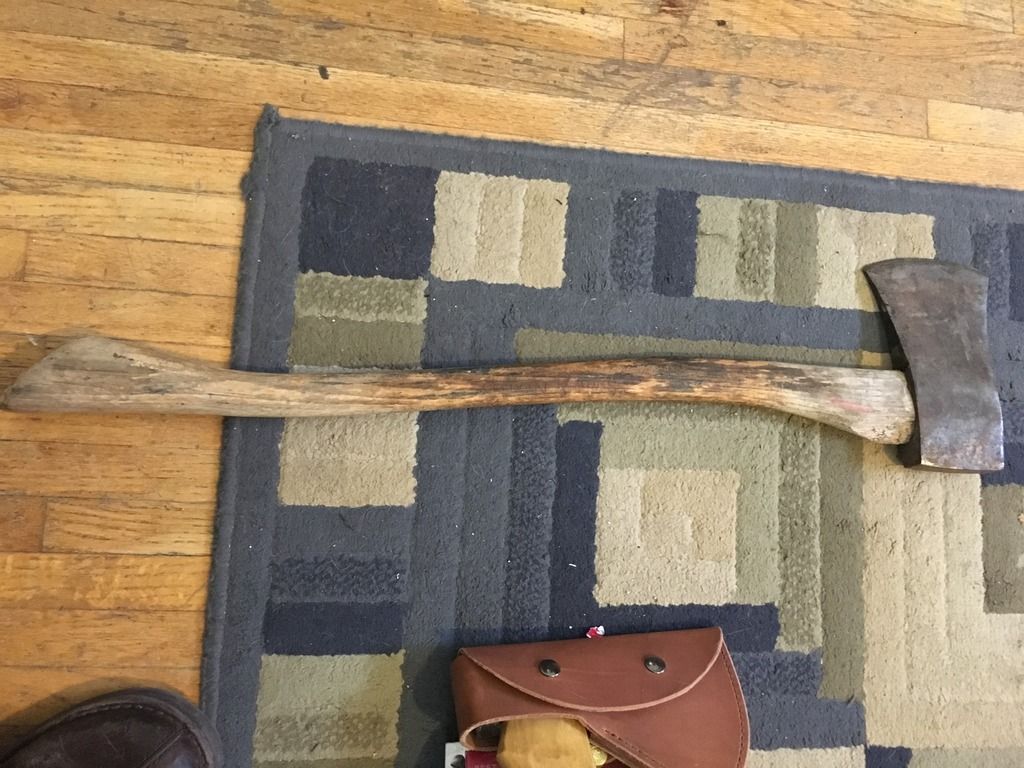

Got this from a friend who got it from his dad. He works for the forest service here. From what I have read, due to the fact that it isn't stamped on the head, it most likely is imported. Here are some pics. I would just like to be sure
From the 80s until 2000 the heads were unmarked, but USA made still I believe. How's the steel?
I would guess US made based on the full fawn foot marked handle and the original smoothness of the head.

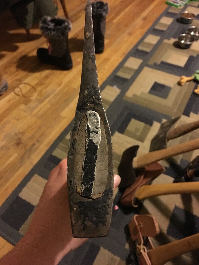

This has a metal wedge too. Is that common with all s&n axes?

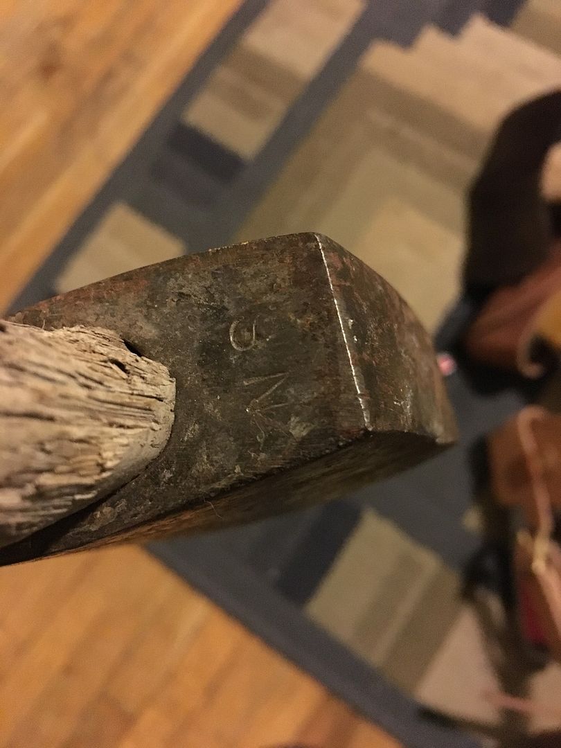

Didn't notice this before, but there is a "SN" stamped under the poll. No weight stamped
So, does anyone know the significance of the SN stamp in relation to date of or country of manufacture? General consensus seems to be that it was of domestic manufacture?

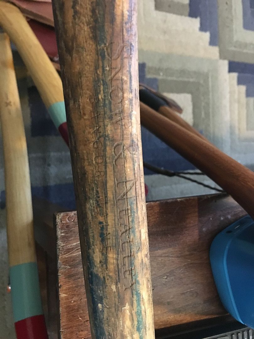

Of all the Snow and Nealley axes I have examined, the SN stamp where the weight stamp usually is located is not particularly common which leads me to believe it was not done over a long time period. If I had to guess based on the shape of that handle you have something from the 90's but that is only a guess. There is a fair amount of guessing that goes on with Snow and Nealleys and dating exactly is a bit of a trick because there isn't anyone who seems to know, just a bunch of guesses like what I am doing. I do think by the look of it that is a USA made S&N axe, just not a particularly early one. The markings/font of the writing on the handle and the shape suggest a later manufacture to me, just before they moved out of Bangor but the overall wear and look of the head says pre China, that is what I am basing my guess on.

What year did the rounded nice, elegant looking fawns foot handles change to the flat slab sided one like the axe in this thread?
What year did the font and design of the handle mark change to the one like the axe in this thread?
