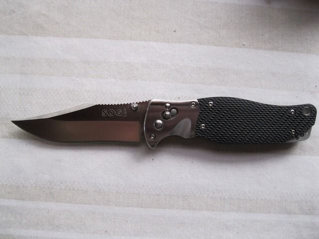

is this a fake??? help please
Looks like things changed before they completely changed the logo.
You're right. Didn't see any photos of the other side of the blade.
All the current Seki Folders have the model on the side with the SOG logo.
They obviously added the model to the folders when the box logo changed to the bullet.
But to the folders only.
My later Seki fixed blades with the bullet logo do not have model names as all the current Taiwan versions do.

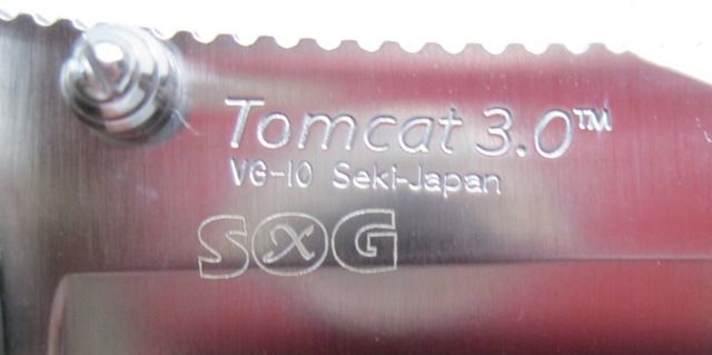

At the end of the day we'd have to look. The etching on mine is different than the one posted earlier, (looks like its cut deeper into the steel and not exactly the same image), so they were likely made at different times during production.
Sac Troop,
I don't know if you know this, but the Tomcat 3.0 photo that you provided indicates a "blemished" knife due to the "X" in "O" in the word "SOG."
Just an FYI.
Regards,
d-1
Thanks for that defiant-1. I have never seen that SOG with X mark before and was puzzled.
