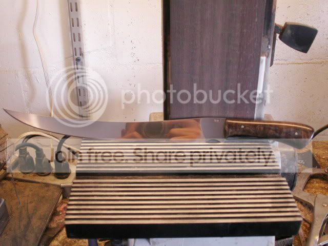

Every single knife I have completed and in the process also were made using that sander. I have two complaints about it. One, I go through a couple 60 grit belts hogging per blade, and two if I really lean into it I can stall the motor. For the price you can't beat it. Others would tell you to get the craftsman model with the 2x42 (or 48, dunno) and I am sure that would work. I bought this model at first to use for model airplane making, and then decided to try knives. Oh yea I noticed your forum handle, I play a Jackson USA Kelly through a digitech GNX4 and Carvin half stack. Death metal rules.
my first ever knife
paring knife
Fillet
nother fillet
