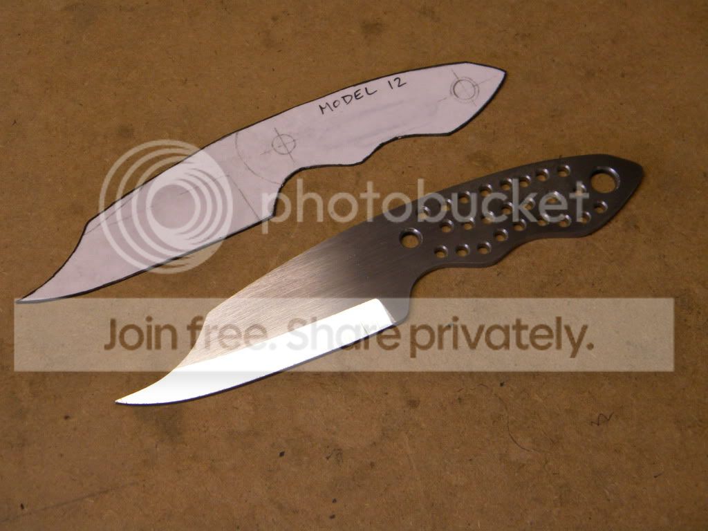

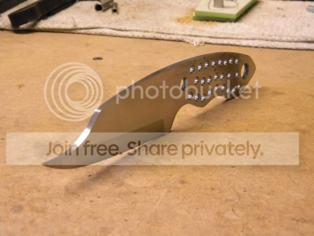

Got a wild hair and wanted to do something a little crazy with a clip point. I might have overdone it a bit but I kind of like it.
Yes, the tip is going to be thin, but no thinner than say, a Spyderco Military, maybe a bit thicker even. It's not supposed to be a prybar, after all. Should slice nicely though. It probably won't need one of my swedge treatments either, gonna be plenty thin without it.
Anyway, this is the initial design with the initial bevel roughed in just to give me an idea how it's going to look. I'll have a few of 'em in my next batch for heat treat. After I profiled it and started grinding I kept looking at the wild clip and all of a sudden, something came to mind......

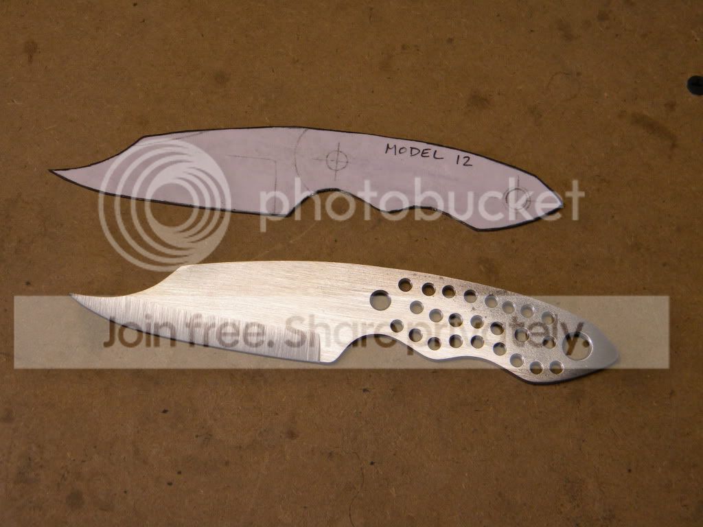

Hey Frank, maybe I didn't say it clearly enough. So far all I've done is set the bevel. At this point I'll get it heat treated and then I'll finish the bevels the rest of the way. You can see in my template in the first pic where I've got the grind lines drawn in. It should end up pretty much like that when it's done.
As far as new models go, it's always fun for me to sit with paper and pencil and come up with different stuff. Unfortunately you get bogged down with work, current orders etc., and sometimes I can forget to push things forward. I've been in drawing mode the last few days though and soon I'll have another design in the works called the Woodpecker, a spin off of this one.

I know you have considered the very thin tip, but I have real reservations on it holding up on anymore use than slicing cardboard. I have made similar knives, and did not like the durability. The whole principal behind a drop point or spear point vs a clip point is supporting the tip.
It looks like the fingernail-cleaning tip on some SAK's. I modified the spey blade on a stockman to look/work like that, but I don't think it would be as useful on a larger knife. (my 2¢)

Jonny, visually I like it, it's different. But as it's been said, the point is a tad thin. Maybe find a way to put more meat on there. I'd say with a spear point but that may be TOO different. :o
I think it would be fine for general kitchen chores, or even tasks like cutting leather, but I don't see it as a self defense blade, or for heavy utility work. It has a faint resemblence to a seax blade, it might be a good idea to examine the tip of a seax to look at the geometry (just a thought).
A more shallow (lower grind) with a secondary bevel may result in a stronger tip. What do'ya think?
