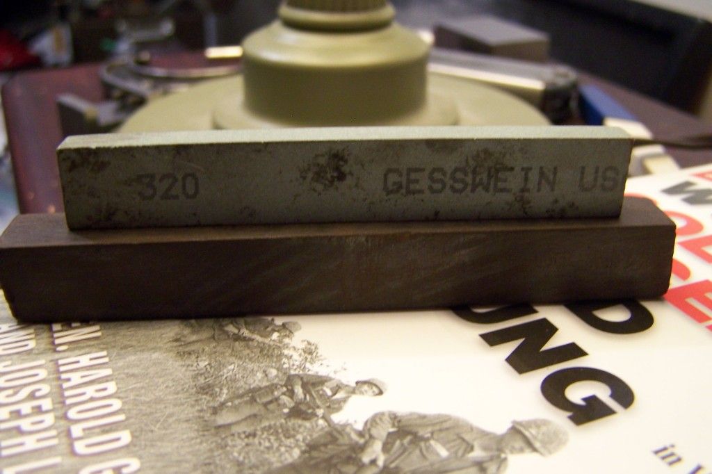

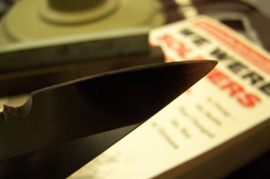

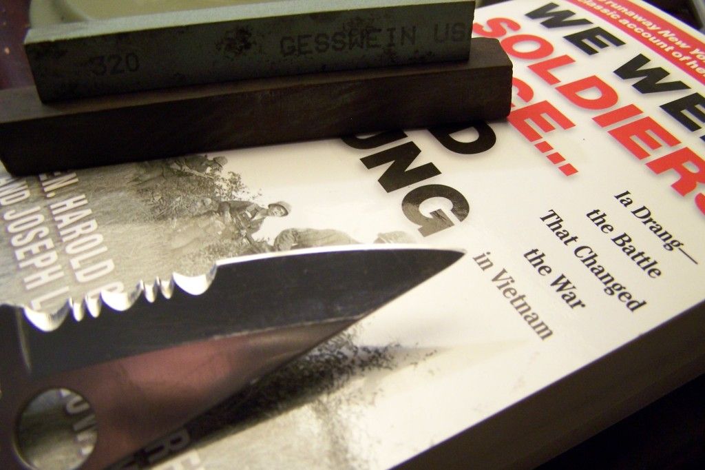

Using the "shadow elimination" method, I resharpened my ATS-55 Delica that hadn't been sharpened in a month or two yesterday with a green stone marked 320 used for sharpeneing carbide bits in machine tools and a straight razor hone that had a metal holder and was in a fishing box I received. The edge G got was hair popping, no, hair exploding!
The two stones used.
After shaving a six inch long strip of forearm (note that the hairs are everywhere.)
