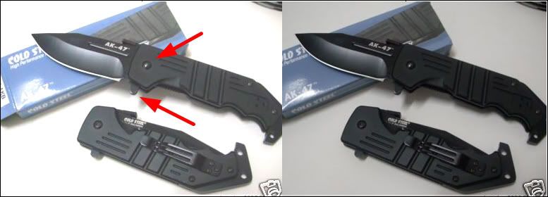

The photo below is supposed to be a Cold Steel AK-47. It's shown on eBay as dark so the details can't be seen. Fortunately the photo can be copied and lightened. This knife is a liner lock. I've reported the guy a half dozen times and he's still making the offering.
CS president Lynn Thompson said anyone low enough to steal someone else's design should be whipped, tarred and feathered. :D
