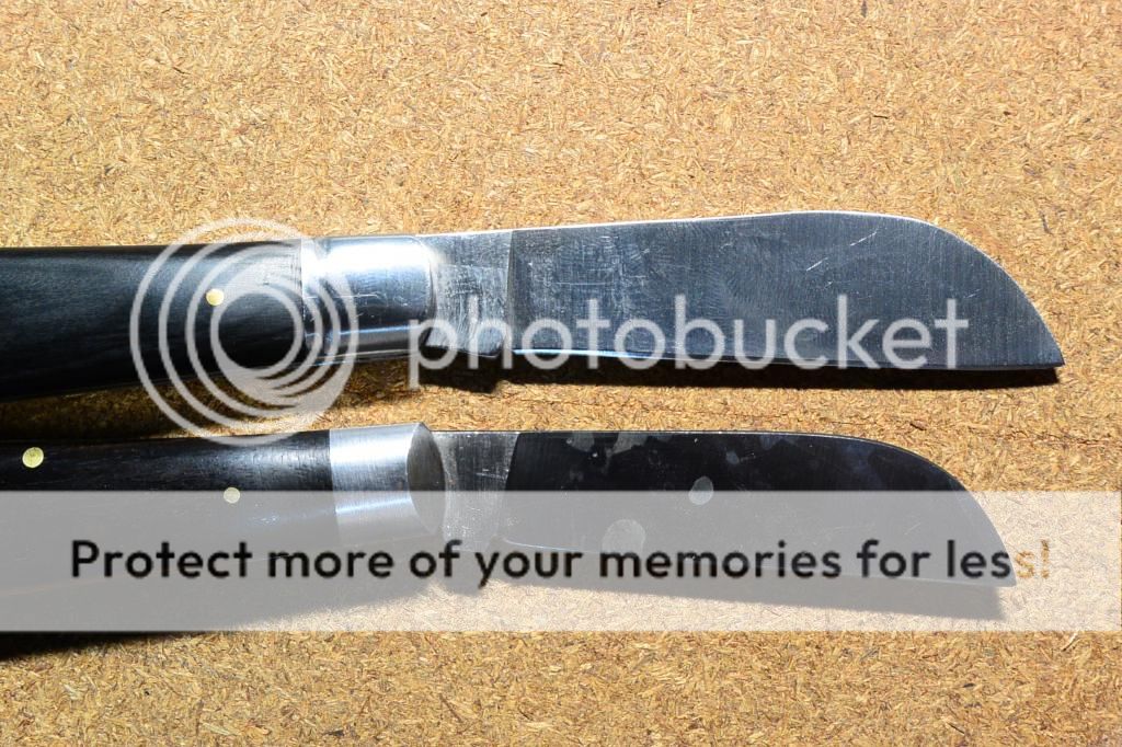

I've got a couple of knives that have a strange characteristic. When fully opened, the spine of the blade is not "square" with the backspring. So the blade looks kinda like it's 95% opened but in actual fact it can't go any further. In the pic below, the bottom knife is the guilty one. Compared with the top one where the blade spine is straight and flat with the backspring.
When I lay that bottom knife edge up on a flat surface, the spine of the blade does not touch the tabletop at all.
So is this normal and acceptable. It does not affect the usage of the knife except that the blade is tilted down more than usual. Is there any way I can "straighten" it without sending it back to the manufacturer?

Looks like the back spring or the notch on the tang is too long. File the spine of the blade where it contacts the back spring and that should take care of it.
You would have to ask the original engineer if this was intentional or not. Many blades are left south of parallel on purpose; thus I would not just assume there was a defect on an entire run of knives. Since these are stamped out, there is no real stock removal on the tang or backspring during production - thus that is how he wanted them.

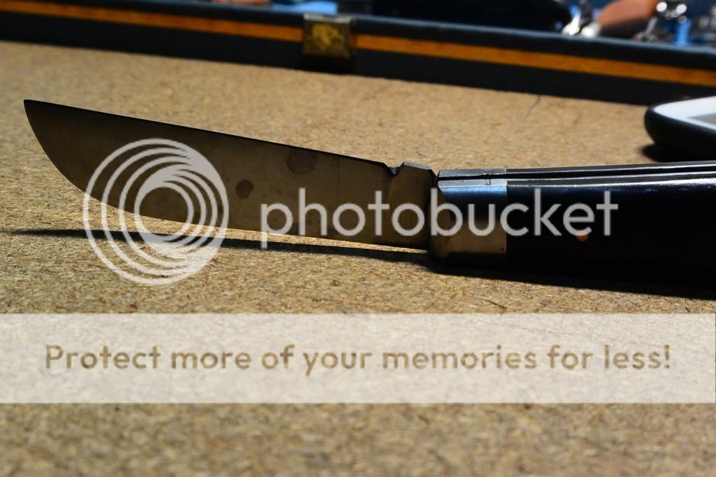

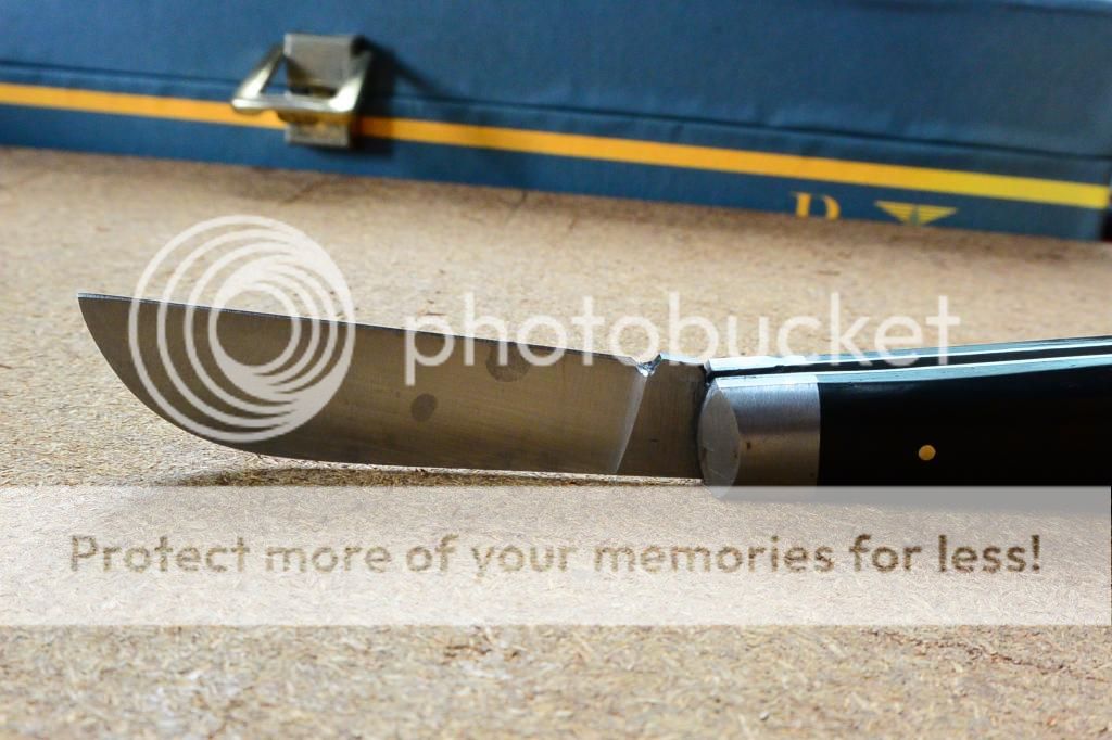

After re-reading pertinux's post above and staring at the pictures she so kindly posted, I said to myself "Aw heck! I don't care what the original knife designer intended. That's not how I want MY knives to look." So out came the tiny files and I got to work. I took away some material from the blade tang area as shown circled in P's second photo above as well as from the face of the backspring as suggested by Mike (Knifeswapper). I used masking tape to cover the blade and to protect the areas that I did not want to get scratched. I worked slowly as instructed and checked often. I started out with this :
and 45 minutes later. I ended up with this :
More "normal" looking in my eye. I love it. And as pertinux mentioned above, I too did not notice any other negatives in the knife after doing the filing. Walk, talk and snap etc are the same as before. No more "crooked" knife for me!

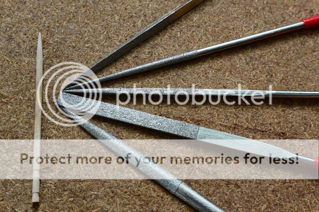

where do you get a file small enough for this minute type of work?
Is there a name for this type of file?
I don't know if there's a name for them. I just happen to have a set of small files I bought sometime back from the local hardware store. They are not top quality but they get the job done.
Here's a pic of the set of 5 with a toothpick for comparison.
