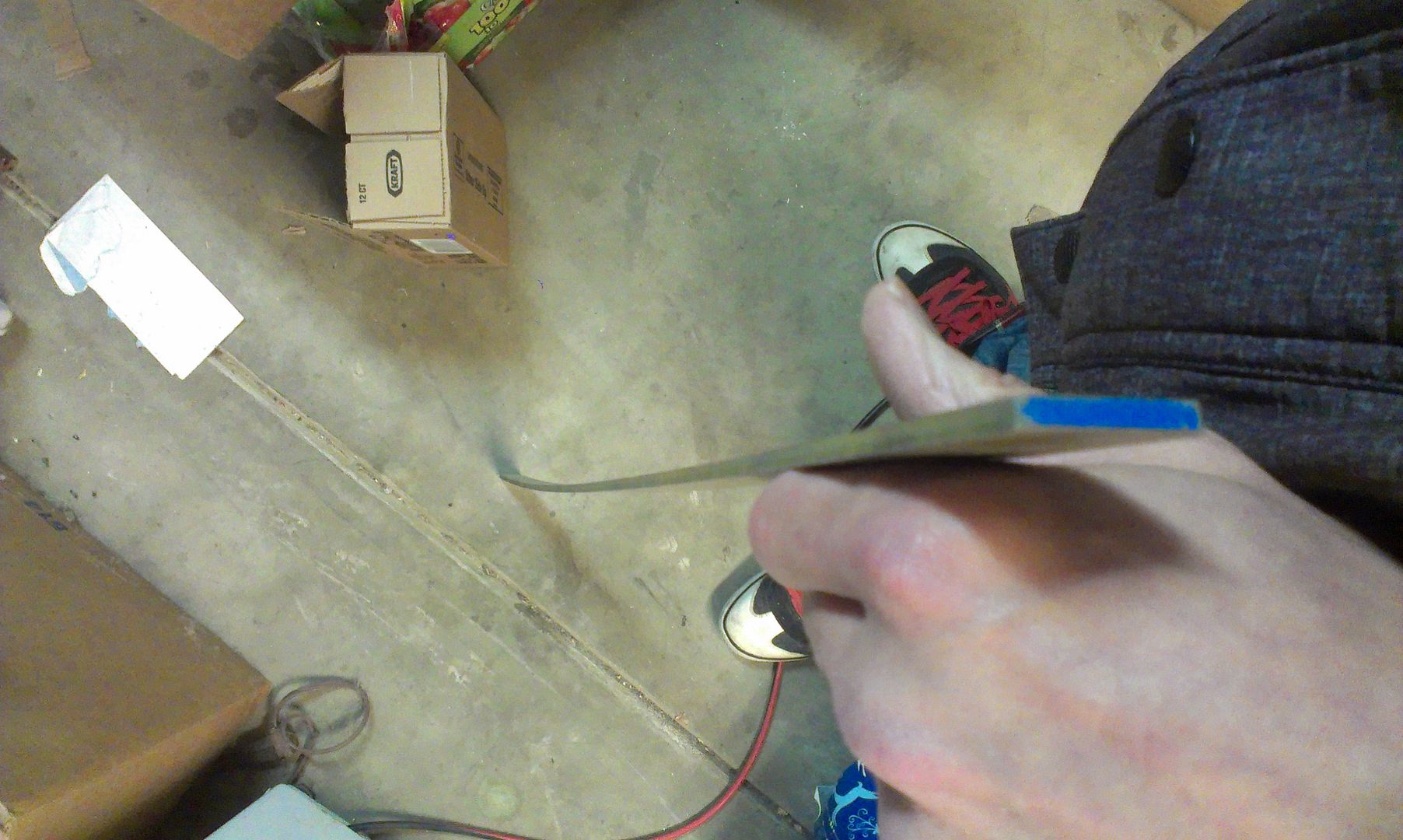

Just got a bar of steel and it's a little bowed.
I've never had steel show up bowed, but haven't bought a stick this long.
Is this expected? Should I try to straighten it before grinding?
Sorry, I know, stupid question.
Ifg it's precision ground I would call the seller up and ask if they want it back. If it's a piece of unground material I would remember that when I ordered again. Frank
Its pretty common. What I would do is cut the blanks you need size wise, then straighten each one. I had a 12"x48 " of 52100with almost a 2" rise or bow in it.

I used to work in a fab shop, so I put it through the rollers and 20 sec later pretty close to dead flat. I am lucky I have access to this equiptment tho, I feel for those who don't.
Keep in mind, it may not have left the supplier like that. Shipping companies are not the most careful folks. I have ordered lengths of metals through the mail and had them arrive in horrendous shape...multiple times. I call to tell them how the pieces arrived, they apologize and send new pieces...which also arrive mangled. Eventually I had them send much shorter lengths which finally worked. But I also got a cheap 20 ton shop press from Harbor Freight. It is invaluable for straightening out bars of blade steels.
