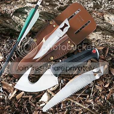

Then it hits me, that I love the hunting knife I've been using for years because it has been so versatile in the field. I try to save weight and space wherever possible. If you've ever been elk hunting in the rockies you'll understand.
It's one of these:
I'd like to carry one of my own, so I'm in a bit of a dilemma. So is it possible to make something with a similar setup? There's a hinged area that flips up and allows the blades to be interchanged. I know it will be a long time before I would able to make something like this if it's possible at all. But it's nice to have a goal :)
With all the talent around here I'm sure it is possible. Looks like a mill would be needed to put a type of notch in it.
I think the hard part would be making a good saw which by the way I always had one of when out hunting moose. That type of slot at the locking end of the blade can be easily cut out by hand with the help of a few drilled holes. Frank

Sweet looking knife at the top :thumbup:. It is a nice idea to make interchangeable blades, eliminates to carry multiple whole knives to the field I guess but I'm worried about the durability problems in hard use :confused:...
Also the gut hook's bevel would be better if it was placed at the presentation side IMO...
Keep us posted, this idea is new to me...

I've been using one of the multi-blade knives for a few years now and it's done great. Field dressed more than a couple deer, antelope and elk and still going strong. My hunting partner and I called it 'wonder knife' up until this year because I didn't know what it was. Picked it up as an impulse buy and tossed the box. Found out this year it's a Kershaw 'alaskan blade trader'. All 3 blades fit in the sheath, handy as all get out.
I think making the locking hinge is going to be the real problem when it comes to durability. The saw blade might have to be retro fitted from an existing saw. I don't know how I would actually cut all the teeth.
I can't seem to find any pics, but I know Bailey Bradshaw has done extremely fine examples of that type of knife.
I think Bailey used his wire EDM to cut the fitting parts. See if you can find some pics... his were the nicest version of this I've seen :)
