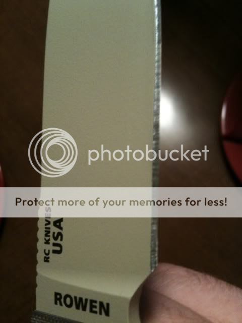

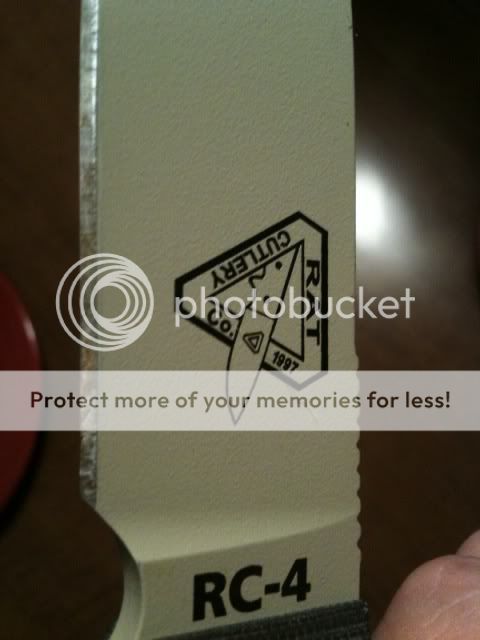

Your knife is just telling you that it wants to make a trip to the woods.
A little use'll get rid of that discoloration lickity split!
B
Lead Away patches from Kleen Bore will take it off in a snap.
Flitz will work great too
Do you store them in leather sheaths? Sometimes kydex can collect moisture too depending on your house.
mustard works great too, Ijust stripped my 1050 AG Russel and had a solid gray mustard patina going in about 15 minutes.
A quick tip for people who don't want to watch their edges on RC knives or who do not regularly strop them.
Go buy a decent lemon. Use your RC to cut halfway into it. Draw your edge through the lemon until it is totally coated in juice and pulp. Leave it to dry and then wipe it off. You should be left with a medium gray edge rather than a bright one and the patina will be much more rust resistant than bright steel is.
it's definitely rust, and it means you're going to die.
and you will being attracted to farm animals
