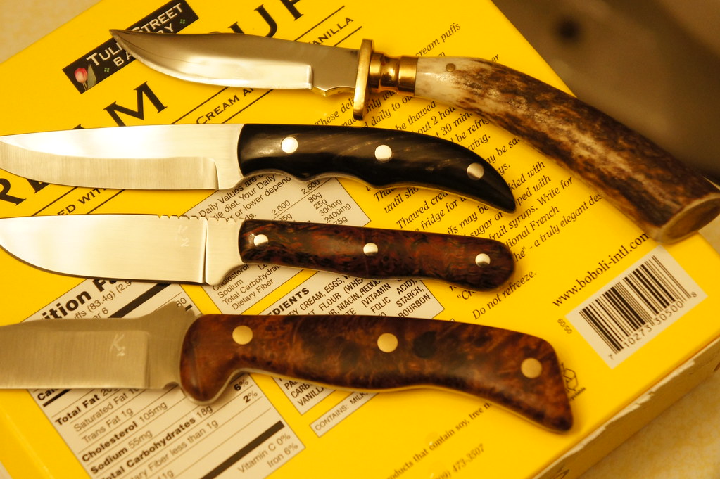

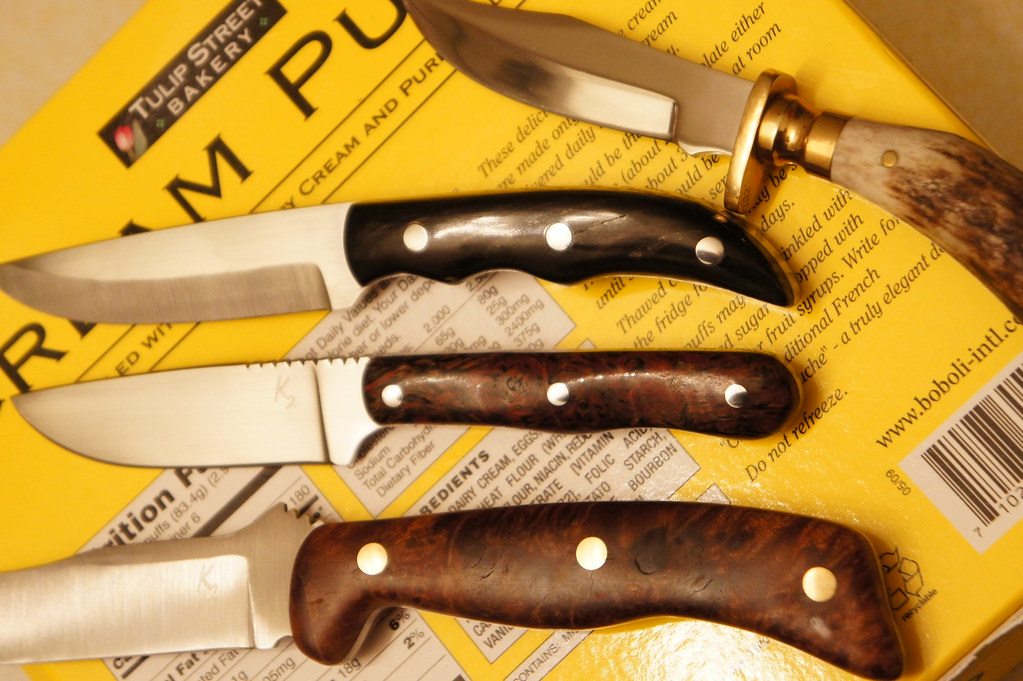

So I followed the same process on each of these scales on the middle two knives (except for the top knife which I didn't make. ..but I did polish the blade using the same process as the other knives scales. My process was: Sand to 600 grit and then use some metal polish and a dremel buffing wheel. The bottom knife was only sanded to 600 grit and then NOT polished, but soaked in BLO. I assumed that the problem with using this metal polish on the scales is that it would heat up the wood too much or take off too much material, but I don't think that either the case. The bottom two knives were rubbed out with old english oil and a buffing wheel (with all excess removed) right before the pics were taken. The two wood knives have also been hit with furniture paste wax in the past and it also produced the same finish as what is in the pics.
So my question is, is the second knife from the bottom (that has been sanded to 600 grit and then buffed with metal polish) as glossy as I can get the wood? I have seen wood handled knives that have a high gloss and I am wondering if those have a coating on them.
If I can get glossier (which I assume I can) I wouldn't think it's the polish since the soft bone and heat treated steel both polished up super glossy. Do I need to go to a higher grit sand paper before polishing the wood? I know that some people go as high as 1200 grit, but ???
NOTE: In the second knife from the bottom the black areas (probably stuff that was injected into the stabilized wood) is glossy, the rest of the handle, not so much.
I would like to get glossier wood scales, but I am not sure if what I am missing is higher grit sand paper or better polish specific for the task. Any help would be appreciated.
If you can't tell in the pics,
The top knife has a mirror finish blade. (I didn't make this knife)
The second knife down has an ultra glossy water buffalo horn handle.
The third from the top has a semi-gloss finish with bits of high gloss on the tiny black areas of the wood (and high gloss pins). The black areas are not burnt, its the dye.
The fourth knife down has a satin, but smooth as butter finish.
I sanded my maple top work bench to 600 grit, soaked it in BLO, and then hit it with furniture paste wax and it was finished at a high gloss. ....so what's up with these knives?
600 grit? You should go higher. I stop at 2000 grit, then use denim to buff it up.
I'm just getting around to starting the handles on my first few blades, but I have worked with a lot of wood in my life. Really the material doesn't matter though. If you want a higher polish you go with the highest grit possible. I'm a fan of a satin finish on blades so as far as I know I don't want to go above 800 there (unsure as I said I'm only on my first few blades), but like tryppyr said I would be going into the thousands with my handles with out a doubt.
Hmmm. It doesn't make sense that going to 600 grit on metal is good enough before polishing, but you need to go higher for wood than plastic or steel. I really don't want to have to go that high. It will change my process for making knives a lot. and MAN that's a lot of extra sanding. I like finishing my handles while they are on the knife, so just sanding the ricasso and handle to 600 and then taping the ricasso for polishing is easy and working well. Oh well.
I still don't understand why my maple butcher block work bench, and would is glossy after 600 but not the stabilized maple burl handle scales.

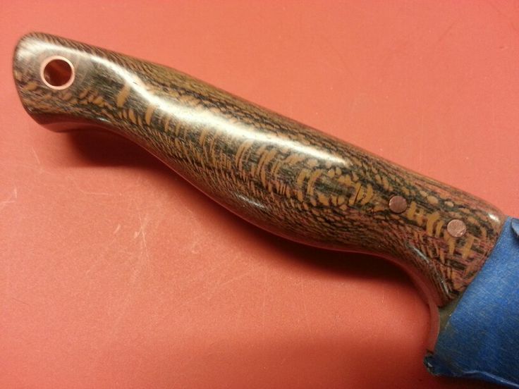

OK. I have taken some of the recommendations mentioned above with my new knife with stabilized wood handles. I realized that people were right is saying it doesn't take that much longer to get from 600 grit to 1500 grit.
What I did:
I sanded to 400 and then wet sanded with tru oil because I swore I read somewhere that wet sanding tru oil was a good idea. Needless to say, I had a mess of a muddy grayed handle and this was a light colored wood to begin with. AKA: A DISASTER I waited overnight for the true oil to dry and tried to sand it out. I got a lot of it, but not all of it. Acetone didn't do a thing since it was in the grain. It looks good enough now though. Sooooo...
I tried again and followed the correct process. sanded to 400 grit, then super glue coated it, then sanded up to 2000 grit. I am now using tru oil (0000 steel wool in between coats) and am on my 3rd coat and waiting for it to dry. I plan on doing at least one or two more coats, but as of now it already looks better than my best stabilized wood handled knife.
So my, hopefully last, question is what should I do once the tru oil finish has dried in order to keep the high gloss? Should I use my minwax furniture paste wax, just put some old english oil on it, meguiars car wax?!, or do nothing at all? Also, how long should I wait after the last coat to do this? Currently I have been recoating every two hours. Do I HAVE to wait longer before waxing it up?
