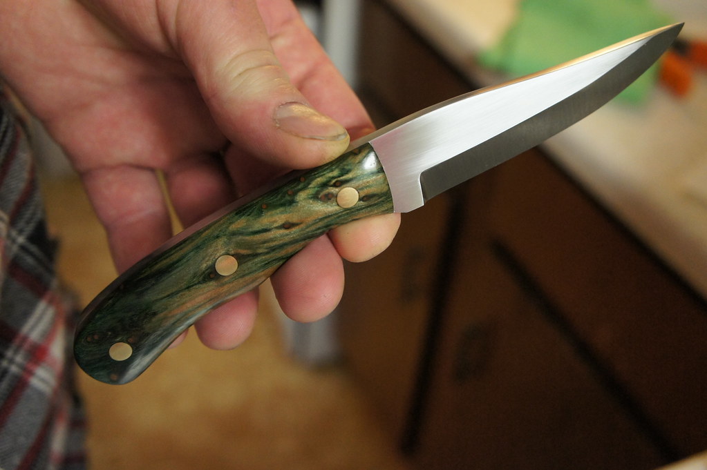

Here is the second knife that I tru oiled. I believe it has 6 or 7 coats of tru oil on it. Pics are before buffing, as the last coat of tru oil was only put on about 2 hours ago. I followed the same process I was led to on the first knife here (minus the wet sanding with tru oil). Others did not recommend wet sanding with tru oil and still achieve great, quick results.
With this knife:
I sanded to 400 grit.
Then added normal super glue (not gel) to the handle. I did not use a debonder.
Stepped up in grits from there to 2000 grit.
Applied 7 thin coats of tru oil and wiped then off immediately after application.
Let dry for two hours in a dry area.
Lightly sanded with 0000 steel wool.
and applied the rest of the tru oil coats.
I will wait 2 or 3 days and then lightly buff with jewelers rouge and then paste wax.
I expect the same results as the bowie / clip point knife above.
I will also probably re buff more aggressively after a month or so.
So again, thanks for all the help. Any clarification on other causes of gummy black tru oil when wet sanding would be nice to know. Purple sand paper also caused the black goo. I would like to try this again, if it can improve my results or efficiency.
At this point, I am able to go from raw bar stock, to a finished product in about 24 hours or so using my beat up craftsman 1 x42 and working in an apartment. I would still welcome anything that can make this process more efficient.
NOTE: This is before buffing.

Since nobody else will tell you what the problem with discoloring was, and since you continue to foolishly think it was Nick's method, I'm going to tell you, it was your sand paper. Dark colored papers will stain wood, especially when wet sanding. Especially the ones you mentioned.

Light purple sand paper will do it too??? Ok. So I guess what ever color the sand paper is, I can expect my wood, at a minimum, to get tinted that color. ..Good to know!!! THANKS! I guess I need to either buy the cheap walmart 3M sand paper or start ordering online and hopefully find a place that tells you the color of the sand paper. Anyone have success with a certain type of sand paper?
Curiously, I sanded a cat scratch out of the green handled knife about an hour ago. It had 6 or 7 coats of tru oil within the last 12 hours and the last coat was only two hours ago. I tested a small area with the purple stuff and it was fine. Then I went up in grits with the gray because that's all I had. I would have expected the tru oil to gum up or smear in the wood and then potentially discolor the wood again. So, I was careful and went slowly. I experienced no gumming, marring, or discoloration?!????

When WET SANDING, you use WET/DRY sandpaper, not alox or garnet paper. Automotive wet/dry SC sandpaper.

Both of the sand papers I was using were wet dry sand paper. Name calling is always productive and taken very well by all. ...so thats obviously been reported.

Rhynowet sand paper from Supergrit is my favorite. It's red in color and won't stain anything. Be prepared to spend a hundred bucks because it comes in packs of 50
You can find Rhynowet in small amounts on Ebay for about $10
+1 for Rhynowet. It will last 1:4 for my other abrasive sheets. Picked it up after visiting Burt Foster's shop and seeing it used all over the place.
-Eric
Just because I haven't seen anyone else say it, but are you letting the sand paper do the work or are you pressing really firm? I'm new to knives but used to do body work. Learned to sand from 3m. Pressing hard only deteriorates the paper and turns it into the "slurry", no matter if it's wet/dry or any other kind of paper.
