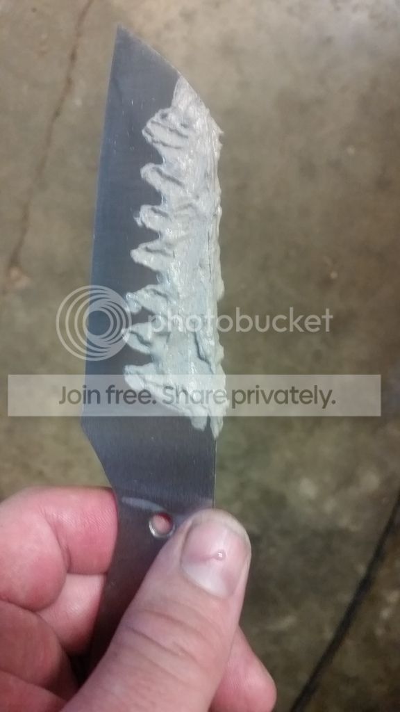

I went ahead and profiled a knife and took it to a 200 grit ugly belt finish. Mixed some satanite and water and applied it to a clean blade. I'm half tempted to do a brine 3 second quench then to the parks 50.
I've seen some killer hamons from that. (Not me personally, I've seen other makers do that)
I think I'll start of with maybe just an interrupted oil quench the first time and save the blade breaking for later.

I got some good advice about taking my clay down through the tang and to go a little thinner so I did that.

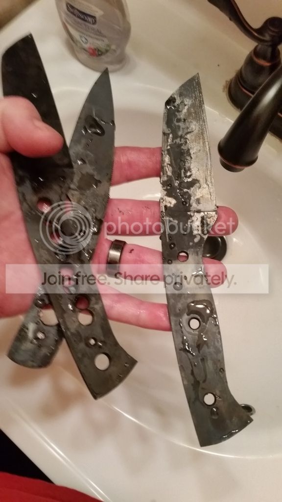

I heat treated a couple 1084 blades and this w2 wharncliffe tonight.
The file skated across the edge. jdm61, I watched some decalescence/recalescence with the 1084 blades with the lights out. (very cool)
The blades are tempering now, I'll try to get some grinding and hand sanding in in the next few days to see if I can reveal a hamon.
If anyone has anything to add, I appreciate all advice and critique. I don't get offended easily so if you see something, say something... wait.
Left to right 2 1084 blades, w2 with clay scraped off.

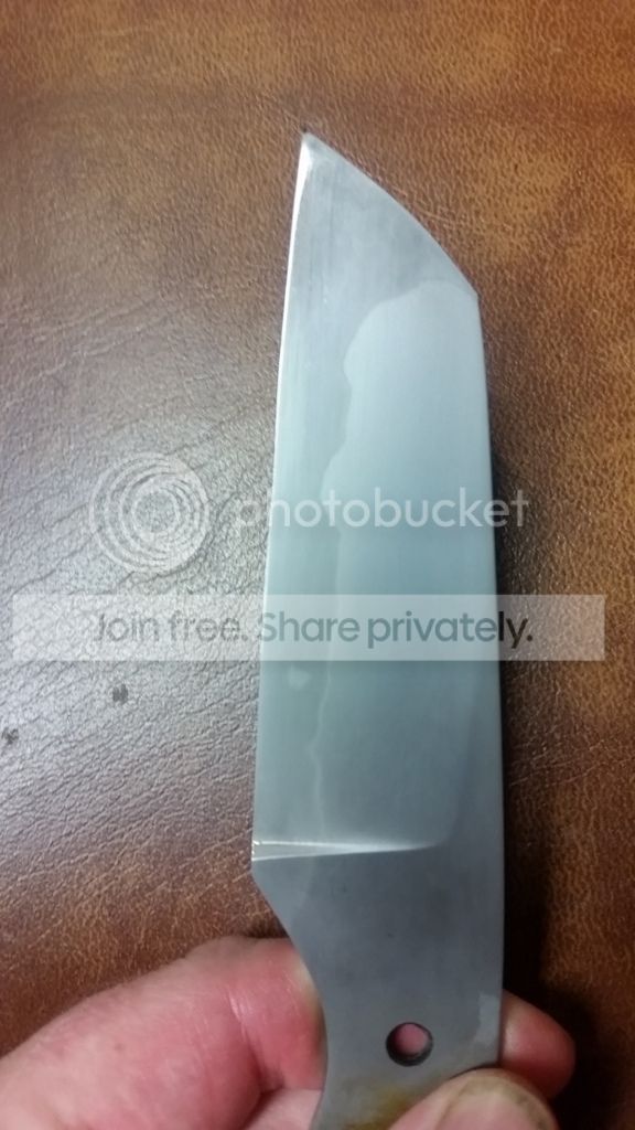

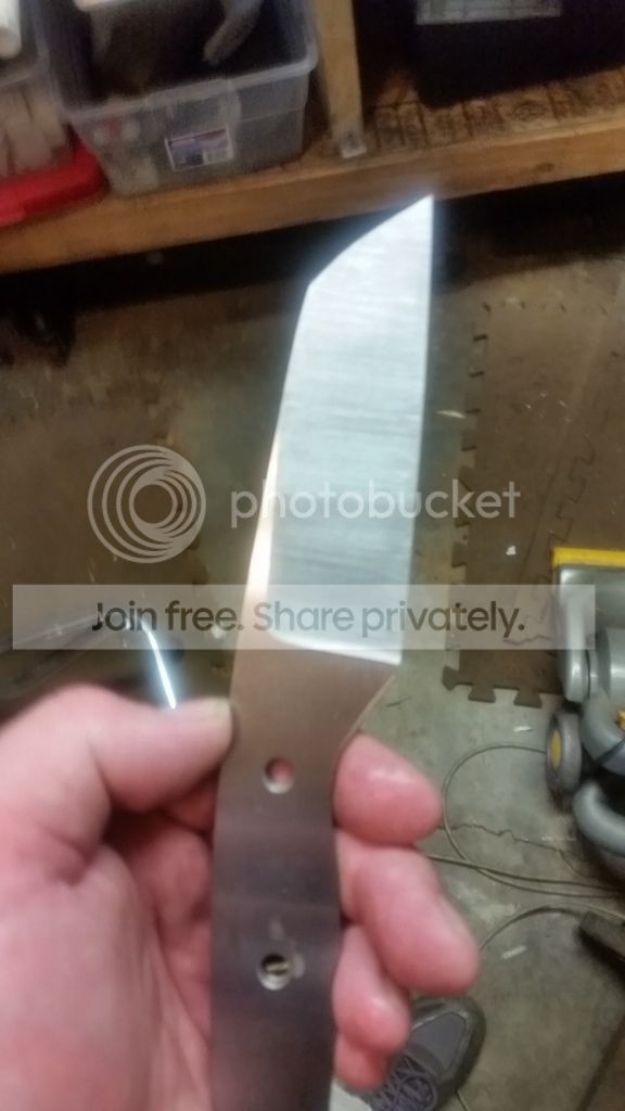

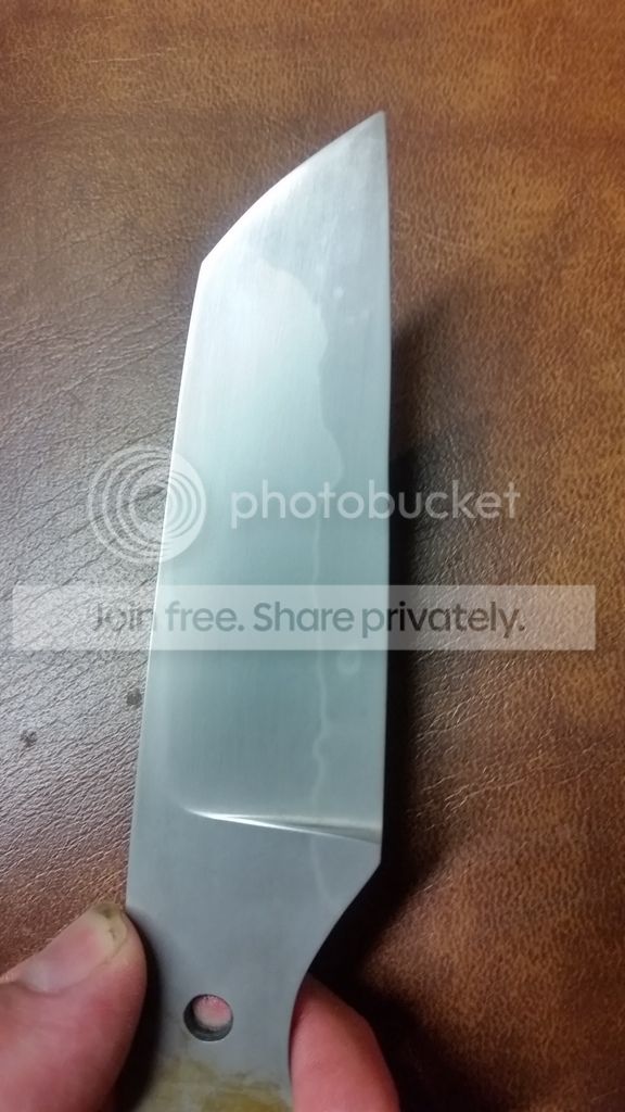

So after hand sanding for hours.
This is what I get. My hamon is boring. I don't expect Nick Wheeler or DH3 hamons out of the gate, but what is causing this? Clay thickness, stock thickness, the way I polish/sand, all of the above and then some stuff I don't know about?
I've tried Ferric and Vinegar with dawn, the latter being what I have better luck with.
I'm not upset or anything, just trying to improve.
Just because I have a hamon doesn't mean I necessarily have the hardness I aimed for, right? After the quench it was 2 x 1 hour tempers at 450 degrees.
This is after several etches, sanding to 1200 grit then 1500 grit silicon carbide powder and even flitz to remove oxides.
Thanks again guys for any tips.
Your on the right track, logs good! Two secrets to active Hamons
Less heat
Less clay
After enough practice you won't even need clay just temp control. I get more active Hamons without clay.

Thanks Kentucky!
Rick mentioned that my clay looked too thick so I'll try less clay next time.
Josh, I think Nick Wheeler also does his hamons without clay.... crazy control. I suspect Mr. Ken Tucky is a freak, too.
I just posted a video on my facebook of a Japanese swordsmith who wraps his sword in thin twine prior to claying.
