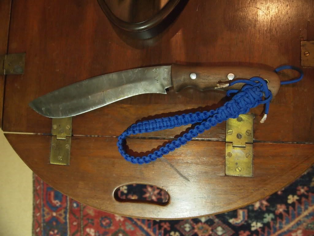

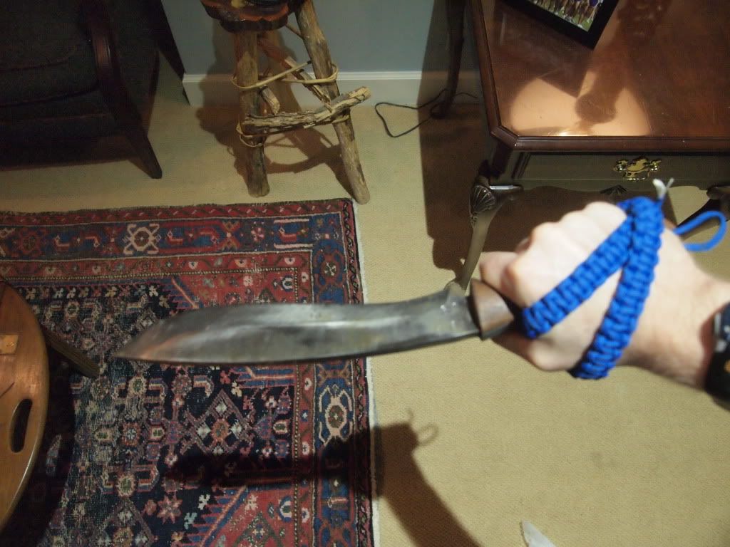

Karda, does your opinion on lanyards include the "loop over thumb" style of lanyard use which is specifically intended to both make the knife swing away from the body, and be easy to drop quickly if necessary? If I had an ASTK and was, say, using it over open water or a river, I might want to loop up this way.
I've got a lanyard like that on my Bahadur,
in an emergency this style of lanyard retains the ability to throw the knife away (throwing out with thumb forward) though if you dropped the knife (low energy slip of it) with the thumb up the loop doesn't slip off. it also makes for a comfortable grip
