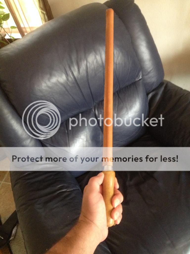

As for steels, are y'all talking about a smooth steel? Like this one?
They are great for aligning the edge in between sharpenings. They are completely smooth and hard, so no metal removal, but they work great for aligning the edge to maintain it if it's already sharp. The "sharpening steels" (with the grooves cut into them) are really IMO just piss poor substitutes for any other sharpening media. They are good for an extremely rough working edge on the fly, but not much else.
The steel pictured above came with a heavy leather cover that works fine for stropping. (As you might be able to see from the cut marks in it):
Yes,
A smooth steel like yours works great for honing as you mentioned and the leather slip cover is a fine way to strop.
