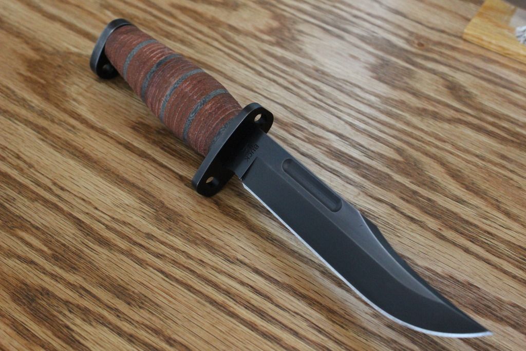

Took delivery of a new 119 Brahma today and while I love the knife overall it has a fairly significant issue. The guard is so loose it literally rattles around side to side and back and forth. The pommel, while fairly tight can easily be turned CW and CCW several degrees. The end piece on the pommel has a hole through it that I assume is for a lanyard. Was wondering if it was possible to just run something through the hole as a lever and just tighten things up? All the leather and micarta rings/washers are tight and except for the loose parts I love it. Really fits my hand well.
Box has a born on date of 4/27/15 so it's been made for awhile. I can return to the retailer for exchange or refund or send it off to Buck. I'm thinking Buck is the better course as I know it will either get replaced or repaired properly. Anyone else gotten a loose one?

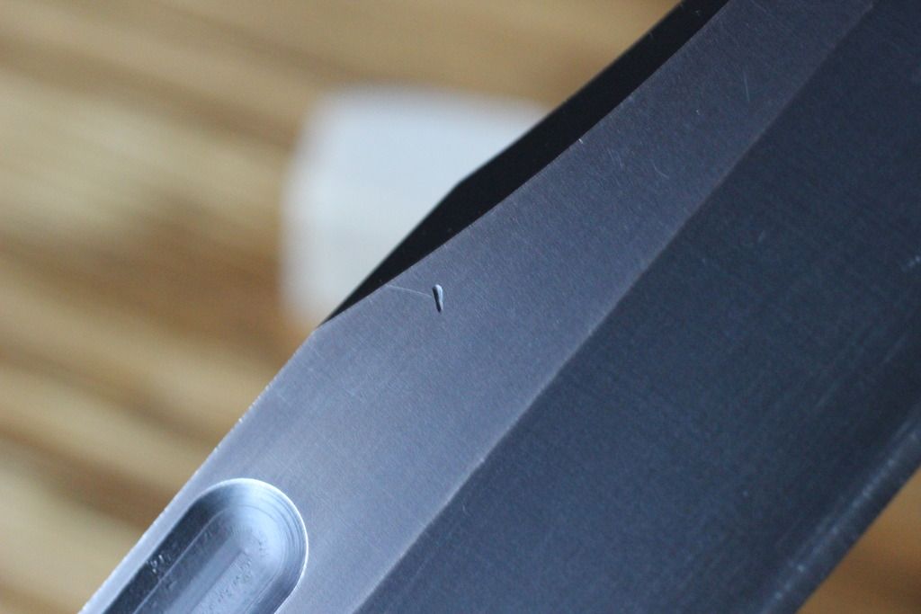

Show us photo's of these issues! I do remember a thread not long ago with a loose handle after it was being used....do a search. If I were you I'd send it back to Buck so they can see if they have a MFG line issue. Mine has a tight handle, but has a small pit in the blade see photo.

Not sure how to show a loose guard in a photo. A video would work but I don't know how to do that. I would really prefer it if I could just tighten it up but I don't want to screw it up and or void the warranty by torqueing on something that isn't supposed to be torqued on. I presume that if I send it back to the dealer Buck will eventually get it back but I also think it would be to Buck's benefit to see it first hand in case there is a process they need to look at. I'm betting my issue isn't very common or we'd have seen folks posting about it.
jb that looks like the early version with the thicker handle, perhaps it was an issue when they changed the handle? BH is yours the newer thinner lighter one, or the older thicker darker one?
Mine has the light tan washers. Like I posted it's dated 4/27/15 if that helps with others comparing it to theirs with regards to time of manufacture.
