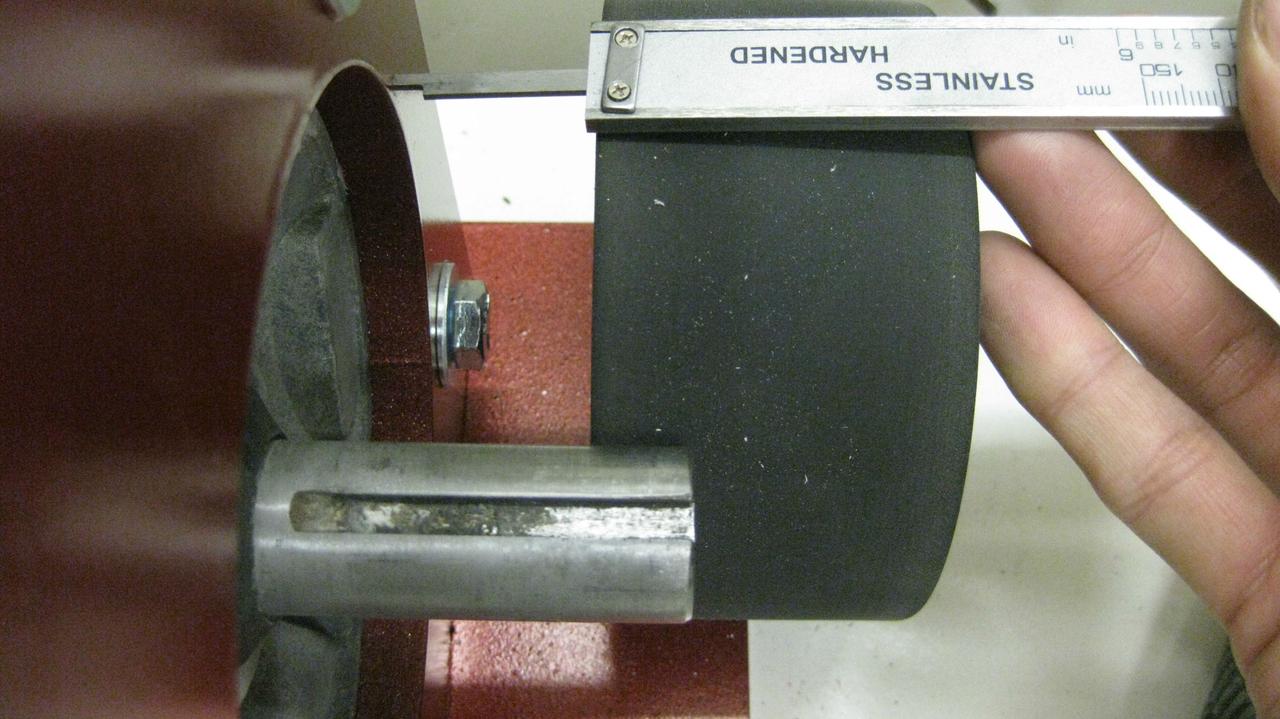

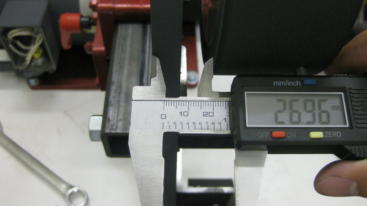

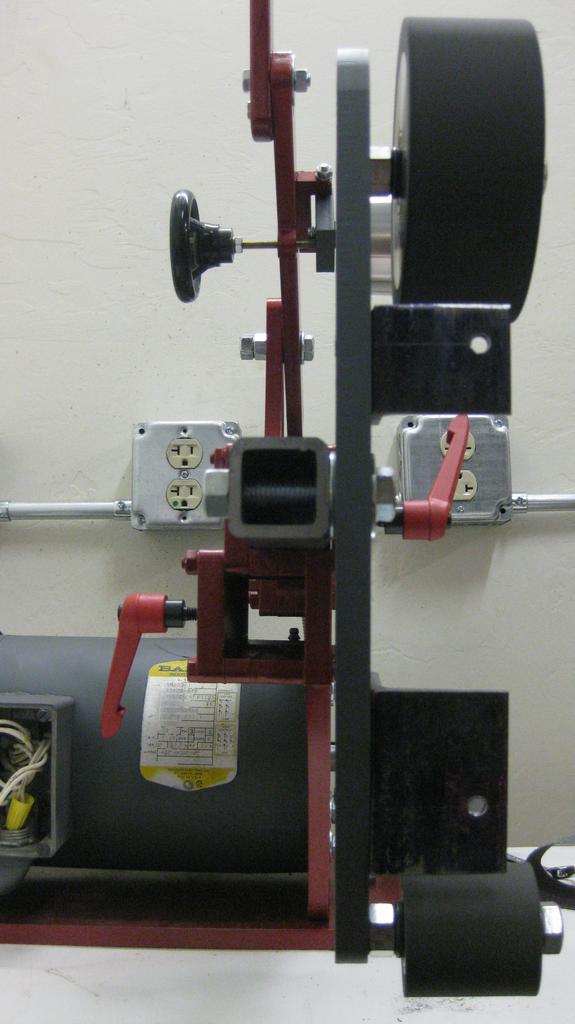

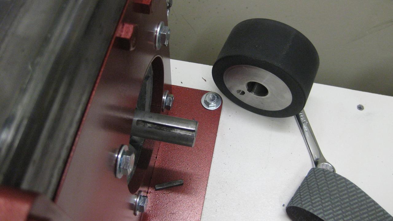

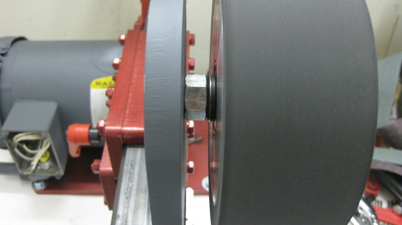

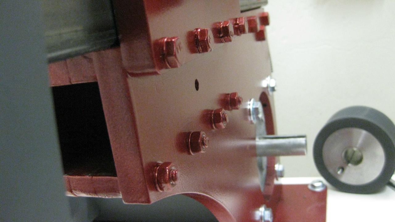

Here are some pictures with my issue. I think what I might do is switch out the tooling arm places, though I will have to paint some parts again and cut the arms slightly. Still would be less to do that than the pillow blocks, I think? Certainly less money and waiting than to get a new drive wheel...
This is the length from the main upright to the contact wheel.
Same length here.
One of the issues I'm having is that there is some slop to the fit. When the wheel is farther on the shaft it's snug, but too far out and it's no good.
EDIT: I wonder if anyone else with the GIB has similar issues? On some 56c frames the shaft length is even shorter than on my motor, which is a 143tc.
I built mine with a Beaumont drive wheel; it works. I used the Alu drive wheels because I have never had slippage or loss of traction once I went to direct drive on my KMG or this GIB. The aluminum wheel set screw is in the circumference of the wheel instead of angled from the side like the Urethane.
Im in the middle of doing a GIB myself, I made up a wider drive wheel for mine so there would be some room to let the belt center up on the contact wheel.
On yours you could certainly get your contact wheels in closer, do you really need the locknuts between the wheel and the platen plate?
Don,
I suggest "do not" build your grinder from the contact wheels working back to the drive wheel...
I recommend you mount the drive wheel first and then work forward to the contact wheel and tracking wheel.
It appears you have enough room to mount that drive wheel on your shaft. Once mounted you then can figure out the spacing for the other wheels.
You should be using washers not nuts as spacers for those other wheels.

I was using the nuts between the wheels and platen so that I didn't have to have so much tension on the contact wheels; they have a lot of drag when I tighten them up any bit. If I didn't use those nuts they practically seize up...
EDIT: I'll check to see if I can find thin hex nuts or a different method to mount them.
A washer will give you enough space for that. Just make sure the washer is not to big of a diameter. They make lock washers in that size that will work as a spacer.

I see. Could be that your inner bearing races are binding on the inside of the wheel. You might see if you can make a spacer for the inside and see how things go. That will at least allow you to eliminate that nut and buy you 3/8 of an inch or so.
You should have spacers between the bearings in the wheels that support the inner race. That would allow you to tighten the axle down as tight as you want without creating a bind.
Without that a good work around would be to use the washers between the wheel and the platen plate like you have; and put the lock nut on the opposite side, the left(outside) of the platen plate
