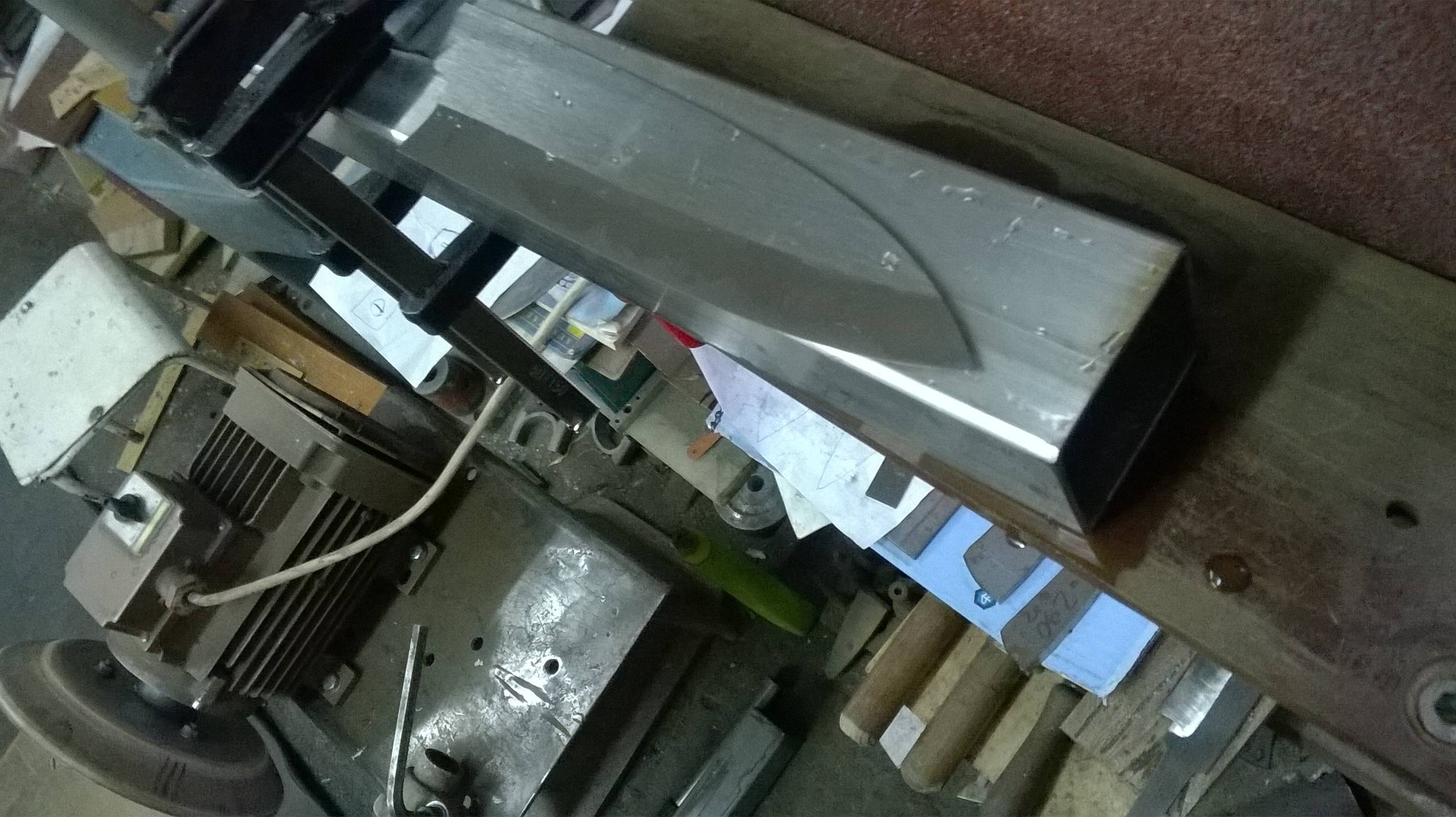

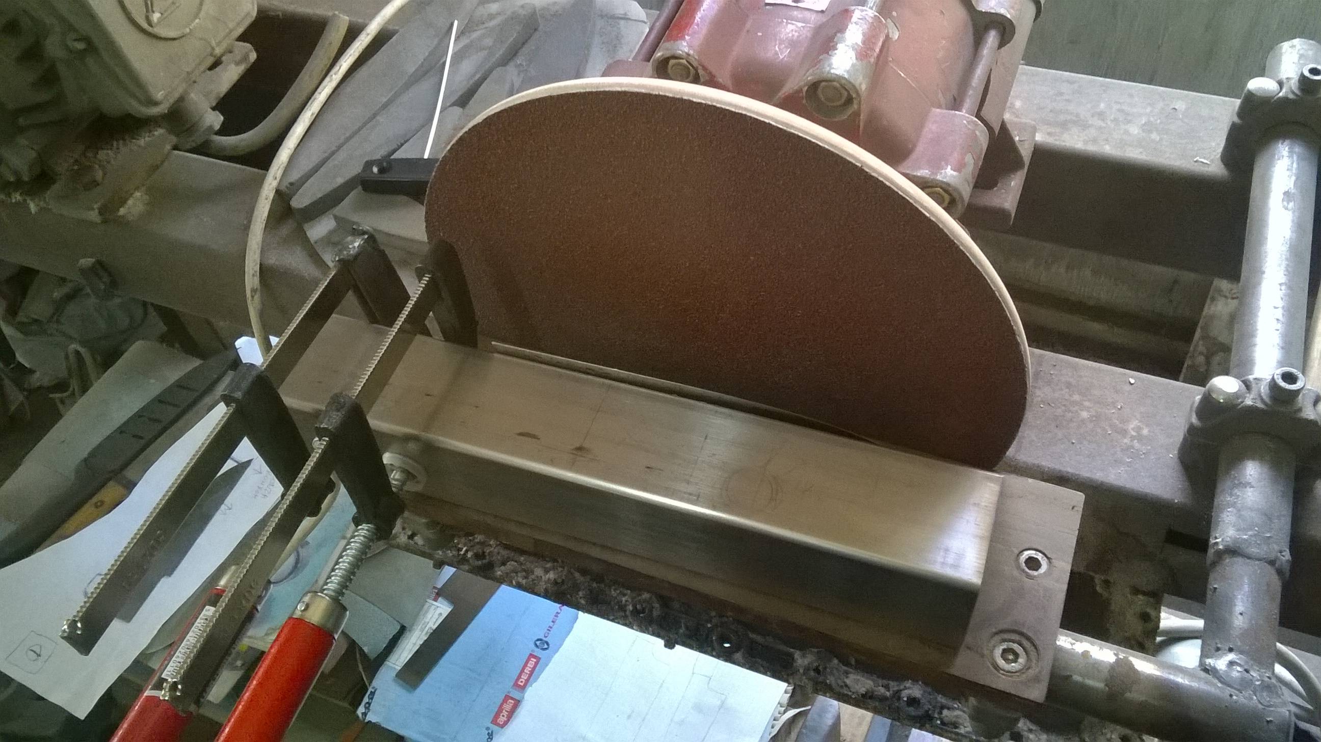

I found that / for me at least / is easy to grind thin blade on disk sander , not on belt grinder .On picture is 64hrc , 1.5mm thick 1.2519 steel .I use this square stainless tube as jig to hold this thin steel . .. . .
