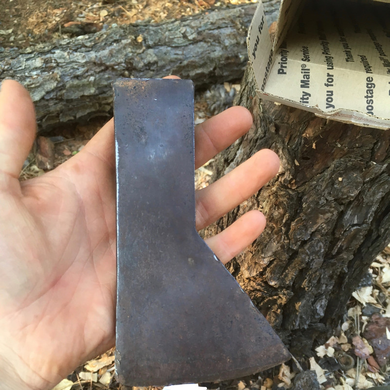

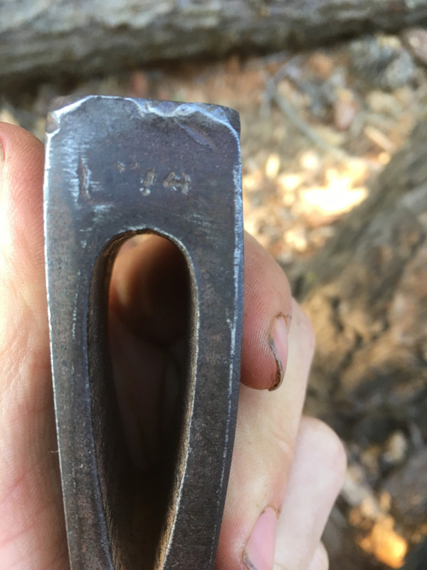

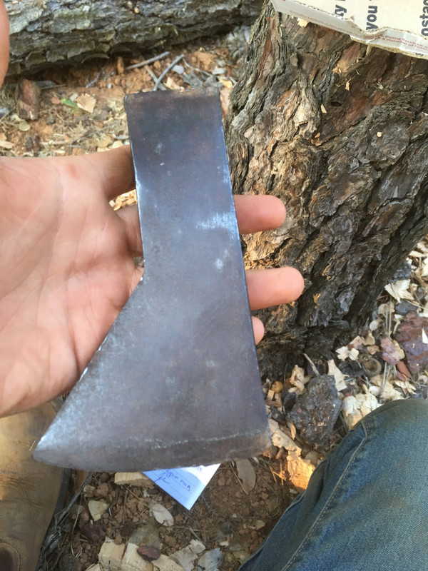

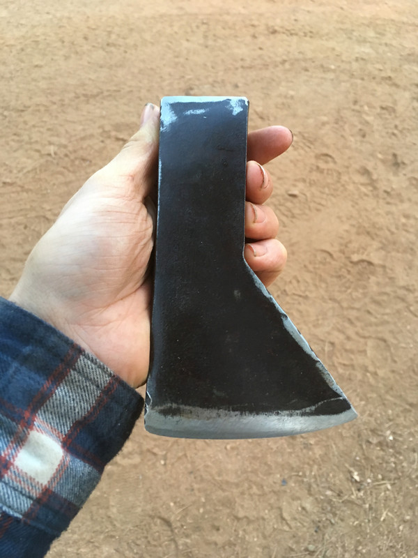

I thought it was an overlaid bit because it was wavy but it's not.
How,exactly,have you determined that it's not?
and though severely pitted i could see there's still a lot of bit steel present
So if it's not two dissimilar alloys joined,than what sense does the above sentence make?
That line is a temper line!
Would you be so kind as to explain this term you used,in terms of physics?(as in what exactly causes the difference in color,when etched or visible otherwise)?.

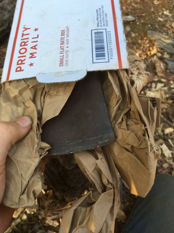

I can tell this craftsman is a more modern axe. There's no signs of forge welding and to my understanding there's no point in forging a one piece axe just to add another piece. Plus i think, not "i know", that the f5 stamp dates it to the mid 20th century. Am i wrong in this belief?
As to the next question you left out the first half of the sentence. Inside the three parenthesis was the missing part.
(((It doesn't have a maker's mark)))and though severely pitted i could see there's still a lot of bit steel present.
Your question isn't all that clear to me but I was balancing the fact that it had no makers mark and was pitted against the fact that there was a lot of high carbon steel left. Really the amount of bit steel qualified the purchase.
And lastly. I said "this is a temper line".
"Would you be so kind as to explain this term you used,in terms of physics?(as in what exactly causes the difference in color,when etched or visible otherwise)?.[/QUOTE]

No,Josh,i was only trying to be brief,and to the point.And thank you for understanding,yes,it's very easy to come off sounding pissy,not my intent at all.
The information you list IS self-contradictory,but it's only too common to state things just in the way you have,and it's not fair to make you the fall-guy for these widespread misconceptions.
A) i hope i answered your questions.
But as to that,no,sir,unfortunately you haven't.
These are the two things i object to:Presuming to be able to tell,at a glance,whether a bit of dissimilar alloy composition was added(not as easily done,in all cases,often requiring very careful inquiry).
But mainly is the use of that mythical term,the "temper line".
I've asked a number of very knowledgeable people about that very thing in the past,and the more informed a person is,metallurgically,the more was their reaction to pass a judgement on this very confusing issue.
But the consensus tends to be that no,such thing cannot exist.
A forging,submerged in the quenchant partially,will Not form a distinct line that'd be visible later.
Reasons for this are many and sundry,such as the transition zone is not(cannot be)that abrupt,but rather gradual,also that Were such effect to take place the color-scheme would be all different(and still not abrupt,but involving a wide-ish transition area).
But,i've raised this very question before,and with no results,so i'll desist.
I do apologise for choosing your post to pick on,it's certainly nothing personal.Good for you for getting a hold of a nice old tool(sounds like,anyway,my connection speed won't let me see the images...:(..Enjoy!.

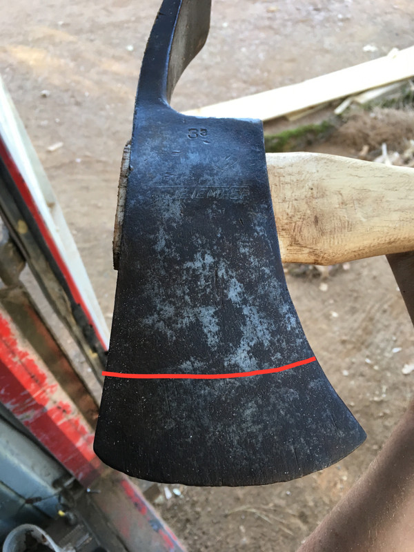

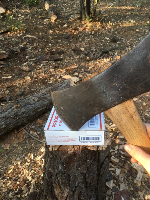

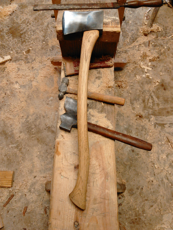

I pulled this off of Bushcraft USA. Maybe this will help. The difference in coloration of the etch is caused by distinct crystalline structures. These are formed in the quench, not through tempering.
That's what i meant this whole darn time. Was quenching. Until last year i mistakenly thought that the quenching process WAS the tempering process. And it's habit to still confuse the two. I even described quenching and called it tempering. I feel dumb. . Perhaps this is where the confusion started.
That darkened steel on an axe bit is definitely hardened, and much harder than the lighter colored bit above it. Applying some pressure with a knotted cup brush on an angle grinder to the line will prove that beyond doubt.

Yes, it has to be quench line related. Otherwise how can we see the line in a Plumb mono-steel axe?
https://www.bladeforums.com/threads/plumb-manufacturing-thread.1066763/#post-12177851
And I have a True Temper where the line crosses the top of the head exactly in line with the curve on each side. It's surely not showing an insert or overlay.
But I question why these lines are always curved and longest at the edges. I'm wondering if the increased mass in the center of the axe bleeds heat back over the quench line, changing the structure of the metal there. This way the line becomes a function of both heat and mass. This seems likely to me.
Yes,Sir,thank you,that is just so.
But is that hardness difference due to heat-treat,or are there two different steel alloys welded together?
For it just so happens that a certain % of Carbon(incidentally the very thing that makes steel hardenable,a nominal min. of 0.32%) makes alloy etch Dark(-er),than a low-carbon alloy.
Where the hardened portion of a solid steel forging does Not have that clear of a tendency...Actually,especially under a knotted cup brush,it'd have more of a chance to blend in,or to appear shinier...(being harder the scratches are smaller and reflect light differently).
Here's a funky deal:There're those that really like the look of that color difference(i'm one of them myself,i think it looks neat).And many of them work quite hard at achieving that effect.
And that,friends,is not at all easy.Some alloys are more suitable than others;some HT regimens are ditto;other details make it actually fairly challenging.
And then,as i said above,it then takes a rather high-grit finish to actually See the effect.(knotted cup-brush ain't in it:)...Circumstantial,yet still I've trouble computing that.

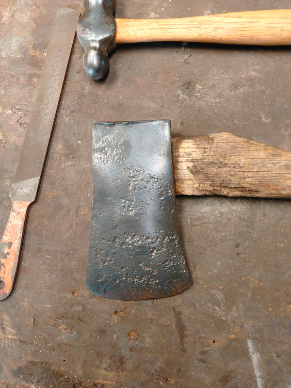

I'm virtually positive this little Plumb head I refurbished, and hung awhile back is a mono steel forging. The Fayette R Plumb anchor brand hewing hatchet laying on the horse.. I'm not so sure.
Here is a thread with some knife guys talking about the difference in a hamon vs a quench line. Probably nothing you haven't already read....
https://www.bladeforums.com/threads/hamon-vs-quench-line.1169881/
Thank you garry3,i've not read that before actually...Very good careful analysis,calling things by their proper names,i really appreciate such info and attitude...
And yes,seems like for a Potential of a clear demarcation it'd take a low-alloy,shallow(fast-)-hardening steel....It does happen to fit in with what most axes were normally forged out of...So the possibility still remains;however,it's just odd that it should be so easy and consistent, with most axes...
Thanks,Quinton,it's an interesting head(and an absolutely gorgeous piece of hickory And the shape&hang of that haft...Real beauty,that).
That Plumb brings to mind yet another difference:Often(not sure about this particular one,judging by photos is of course spotty),but the corrosion on the blade and the body is different.Clearly changing right at that controversial line.
Now in Theory the C content Does affect corrosion resistance(in a negative direction-the low-carbon steel is more corrosion-resistant).
I have found axe-heads where the pitting was very distinctly heavier on the blade.
Not surprising,of course,as the "darkness" on coloration is exactly that-corrosion.
But do we have that effect with isothermal HT,Does Martensite corrode readier than pearlite?....Unfortunately i don't know that.
