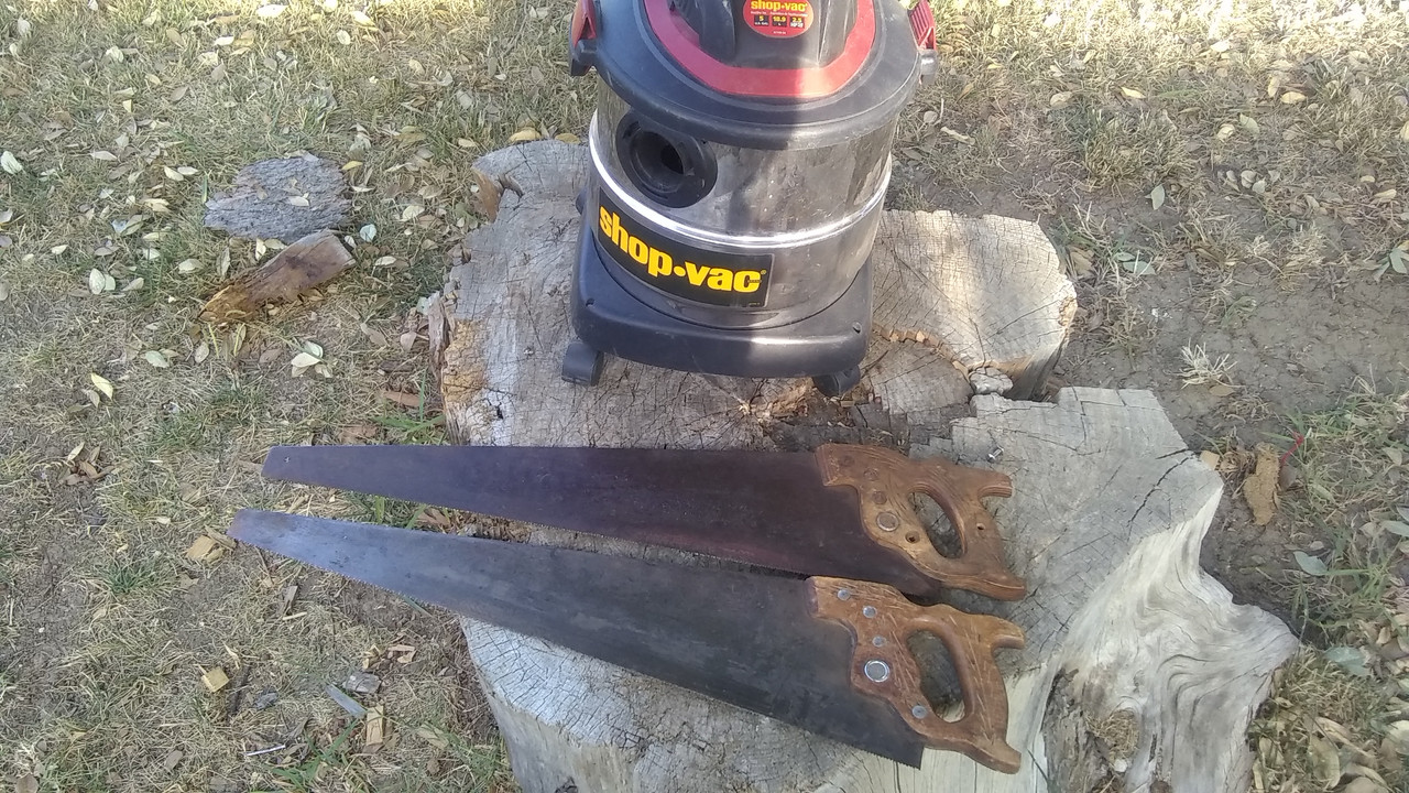

From Goodwill yesterday.
The barely used Shop-Vac was $10, the saws were each $6 and both straight as an arrow.
The top is a cool Craftsman with the fine tooth kerf starter on top.
The bottom is a very late production Disston with no etch, might be from the very last batch to leave the factory in 1955.

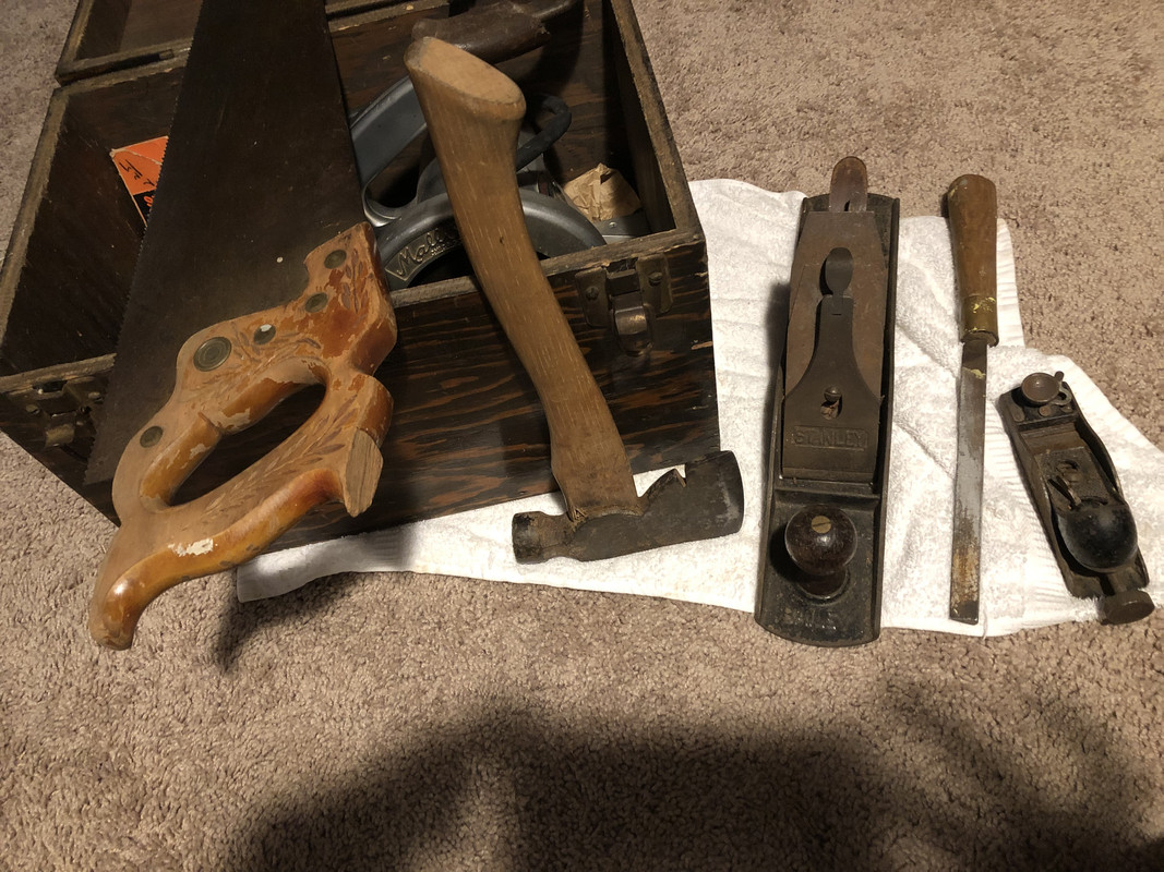

I got these yesterday.
I was under the impression that they were in a little better shape but, besides the one on the top(that can still be salvaged I think), they've got a good amount of life left. Especially the D.R. Barton in the middle.
I think the two stamps are AW3? Not sure what that means? Anyone know? Steel composition?
