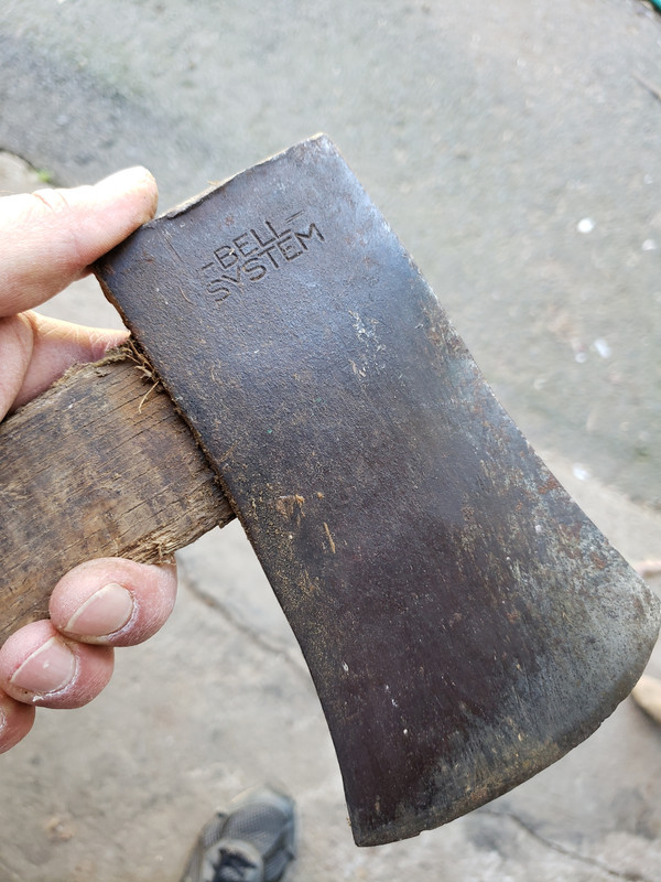

Got a Welsh miners/colliers axe straight from Wales. No makers mark but it can only be a handful of makers. Pitting is so deep that the hardened edge is pronounced compared to the rest of the surface area.
Total length is 12 inches, 5in blade width and 4 1/2in eye. Weight is just under 6lb.

I have a garage-full of grubby old axes I shouldn't have bought, but I had to get these two. The big one hasn't been abused in edge or poll, but it was $2 at the holiday hay-wagon sale because the helve is bent in a semi-circle and broken on the convex side.
The helve blank was $1 at a heck of an estate sale.
The hatchet was $2 at the same estate sale. I'll have to try to weld a fillet over its poxy side, but not till we've had a lot more rain.
Why would you want to add weldment to such a sweet little axe?:)
There's a certain fitting homeliness to it,some rural forge,getting close to the end of a workday...:)
What that divot looks like to me is the smith going about it a bit heavy,and smashing that much softer iron in next the steel edge.Once you do that you're screwed,steel is too hard to level that spot back out.
(i've ended up with this particular pox on some of my own forgings:)
