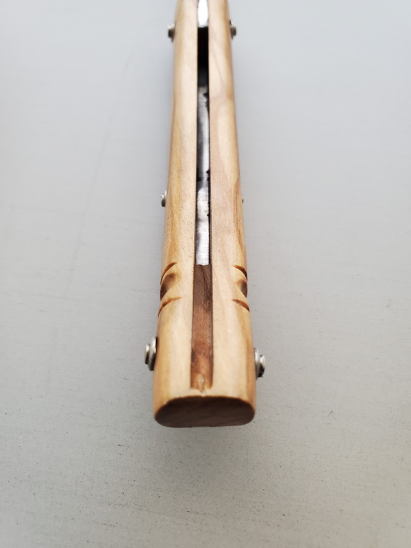

I'm not sure if anyone has mentioned it here yet, but a couple of the knives I got from Consigli have a back spring, but are still made out of one piece of wood (or horn). Is this a standard tradional practice or something that they came up with?
You can see that the handle truly is one piece on this Gobbo

Hello Steve,
You're totaly right. On most of the traditional knives of the continental Italy and in Sicily there is a spring but none of the Sardinian knives have one. The "archetto" is not a spring. It doesn't move .
In both cases the metal will protect the handle's material from the blade when the knife is open .
Even if I love the european-american folders I have to add one point in favour of the Sardinian strategy and I have had some experiences about it :
If, by accident a knife with a spring ( mainly when there is no half stop) closes your fingers will be touched . And with a fast-opening ( closing) liner lock system it will be worse.
But with a Sardinian knife with a good friction it won't happen because the closing will be slowed down by the friction.
Of course the Sardinian knives were part of the local culture and required an apprenticeship. But without any locking system they were used for every daily tasks including defence situations. So much so that Mussolini forbade those knives because too many fascists where killed or injured on the island .
The myth says that during the WWI the Sassary division ( always a symbol for the actual Sardinia) attacked abandoning their official bayonets and used their Pattada knives (which were a bit taller than the actual size ) .

Thanks for the reply. I find it pretty amazing when I hear stories of people using non locking folders as weapons because I would personally fear the blade closing on my hand. A few of those knives you showed earlier are almost swords! :oops:
I carry and use friction folders a lot and sometimes they do fold a bit in use but I've never cut myself with one..... yet!
I will take the good advice here and find an authentic Sardinian knife..... I am fascinated by these works of art!

Another very interesting security element that has been explained to me :
If you look carefully a Pattada knife you will notice that the axis is NEVER on the middle of the handle. So even if the point of the blade seems to be centered (as a spear point ) in reality the point of the blade is always upper than the axis .
Mechanically when your knife will touch a hard surface the blade will go up which is impossible and not down what could be dangerous for your fingers .

Now that you "point" it out, that is so obvious but even with them in hand I had not noticed that detail. Thank you  for helping me to appreciate my knives more and becoming more observant of the nuances of practical applied design. Very very cool :cool: :thumbsup:
