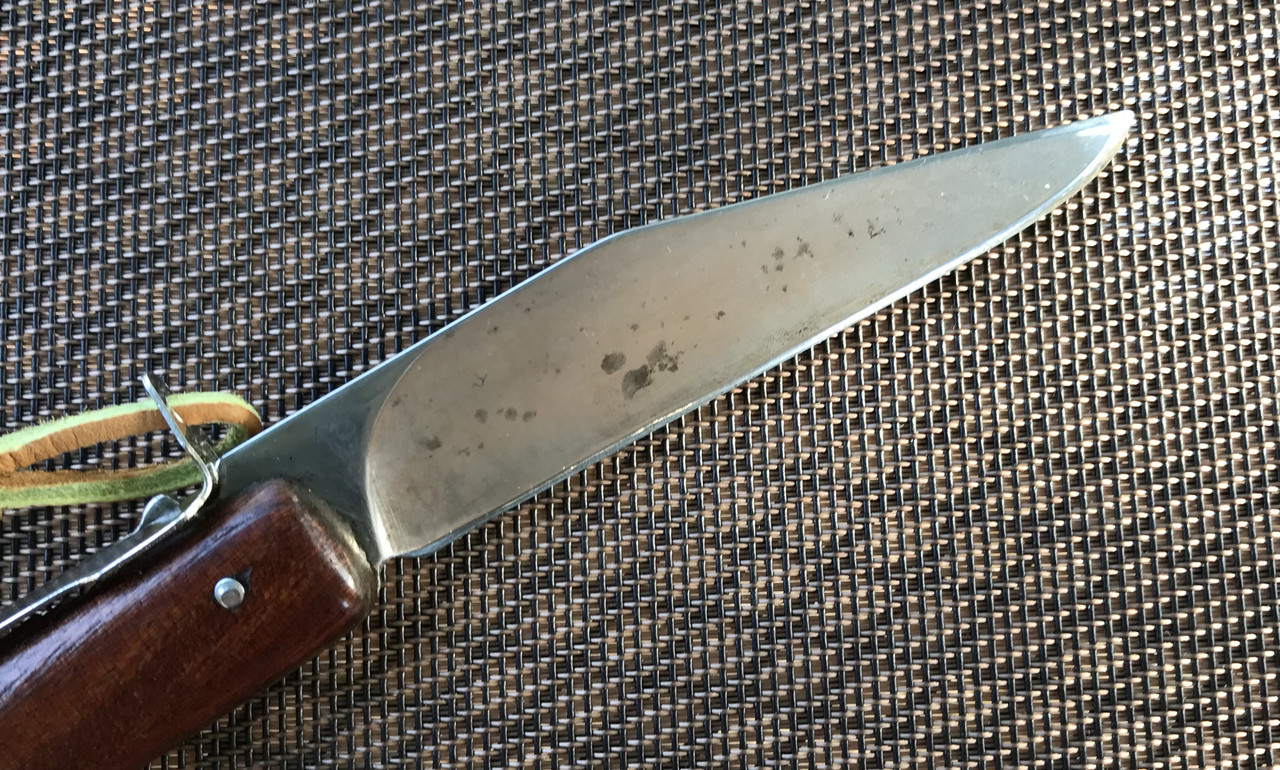

That you get this
Humid as all get out.
As a Floridian, I feel your pain! Keep them heavily oiled and let them ride in slips (but always take out of slip when I get home to let air out) during the summer is what I do to try to avoid that.
Monday temps were in the mid 90’s with humidity around 90%. I was out on my bicycle and stopped for a little casse-croûte around 10:30. Cut some bread and an avocado, rinsed the knife off with my water bottle, wiped it on my shirt, and put it back in my pocket. No rust spots then.
Back home around 2:00 or so, fished my stuff out of my pockets and there were bright red rust spots where you see the splotches there. A little 2000 grit wet-dry sandpaper and some mineral oil and all is right with the world again.

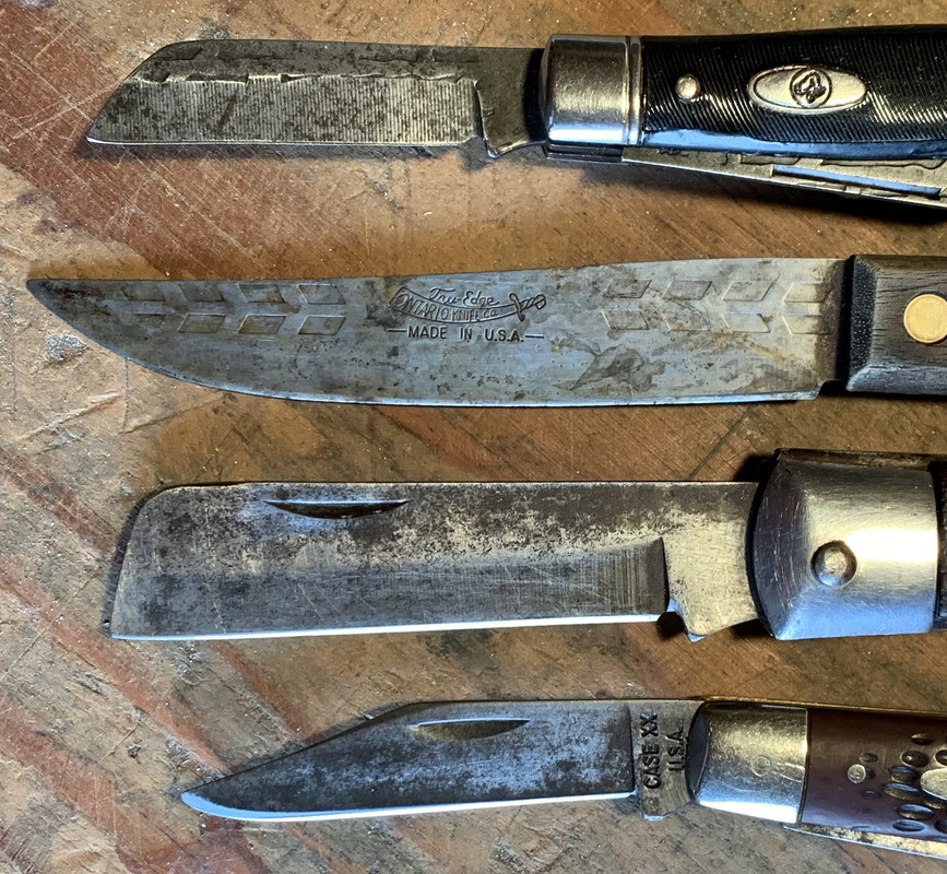

Eventually it will look like this:
Growing up, I didn't know that knives could look any other way.. all mine ended up with black blades...
Around age 12 I got a Schrade 33OT which eventually turned black on me, I thought it was ruined so I stopped carrying it.
I discovered it in my stuff a few years later and took some sandpaper to it, and the blades rusted pretty bad shortly after.
Eventually I learned about carbon steel and cleaned it with some neverdull , this time with some patina it wasn't so prone to rusting.
I’m in Clearwater and I don’t have any issues. I just use them and let the patina develop.
