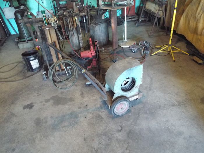

It's that season again, when it's so hot you have to be careful or you can get sick. I hate the heat, and easily get raging headaches from working in it. I got one of these fans from a friend, they come up real often in the scrap bin at any plumbing heating place mostly only needing a new motor. Come up alot at hammer ins for tailgating too. Only need a 1/2 or 3/4 horse motor, and they move ALOT of air. Highly recommend them.
I can't do hot n humid either.
Is that from some kinda HVAC setup?
I'd love to get a hold of one. The shop I work at has a corrugated tin roof covered in a layer of some kind of black tar. It just radiates heat down on you in july and august.
Looks to me it is a furnace fan. The smaller ones are from preconstructed homes. They are often called "squirrel cages". They are great for mving dust as well. Frank

I think I would have passed out years ago without mine.
They can be had for nothing at most recycle places and move a HUGE!! amount of air.

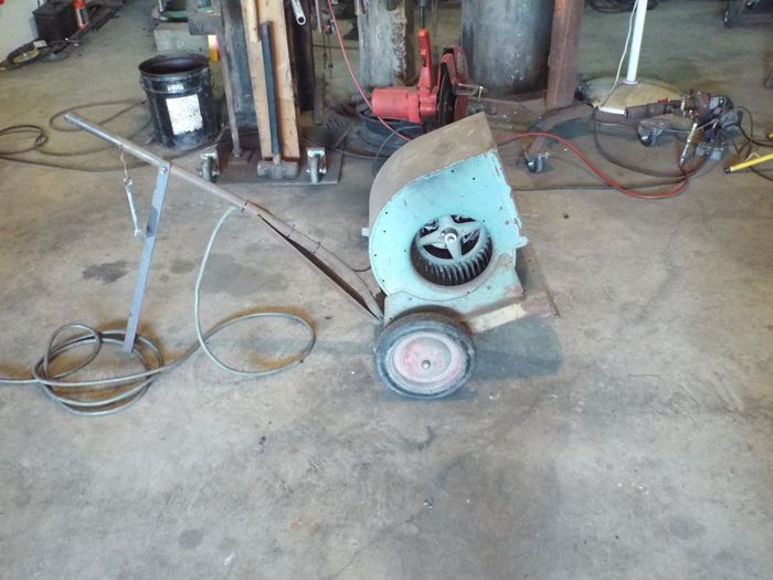

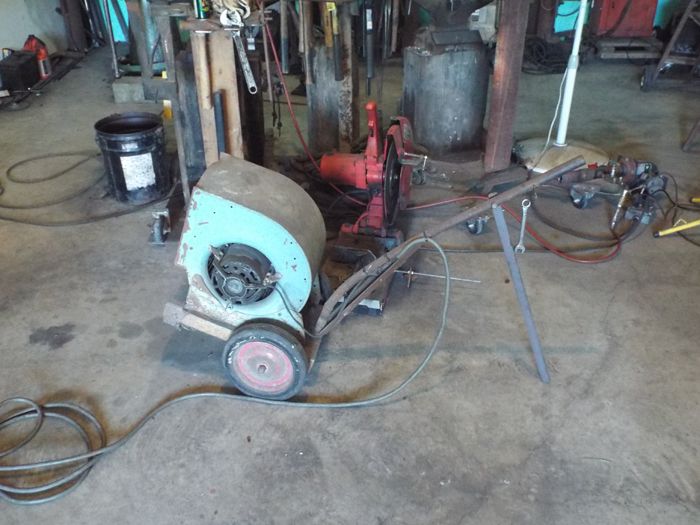

Mine is on wheels for using all around the shop.
I also put an adjustable leg on the handle so I can direct the air where I want it.
Sometimes you might just want to hit the ceiling or maybe swirl air around the shop or even blow off the flloor.
Who knows.
Truly one of those tools I couldn't live without.
