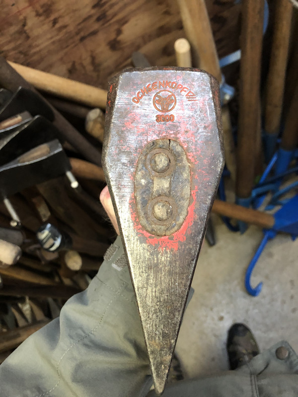

I saw and read those specs and thought that sounded soft for what I want out of this axe. If it doesn't preform the tasks the way I want,
I'll remove the handle and reheat treat it. Bumping it up some higher so it can handle hammering a wedge. Thanks for the input. DM
The eye walls are relatively thick so they might handle light sledge duty as is. I'd be damn careful about messing with the temper. If you must then I'd keep the bit cool the whole time by tying a wet rag around it and squirting it with water the whole time the poll and eye are heating. And I would immediately give it a couple tempering cycles right after quench.
Good advice. So, you think the bit is about right. The poll area may need to be harder. I'll find out once I give it a test drive. Thanks, DM
