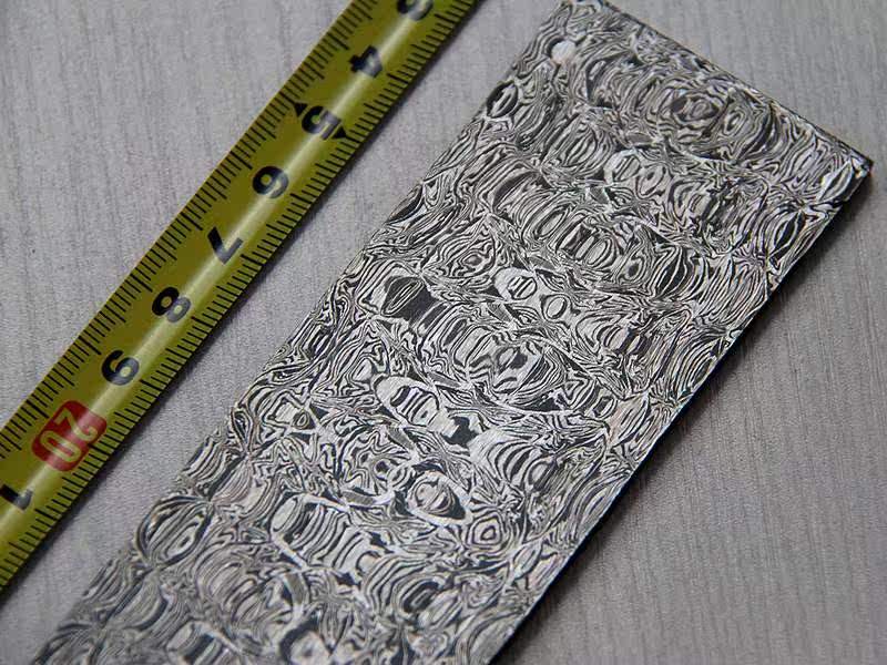

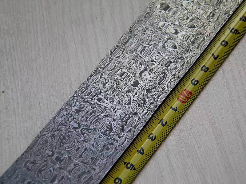

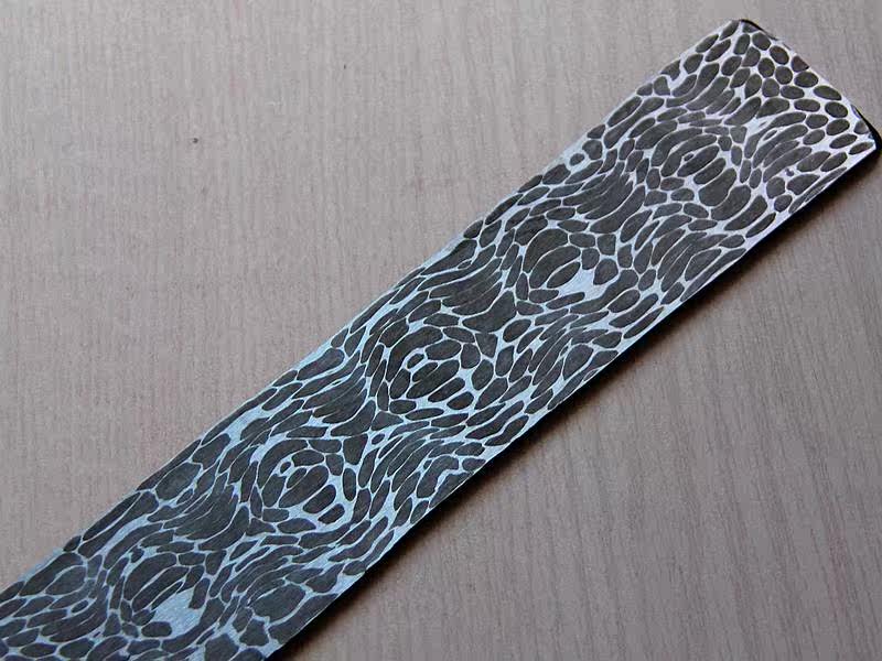

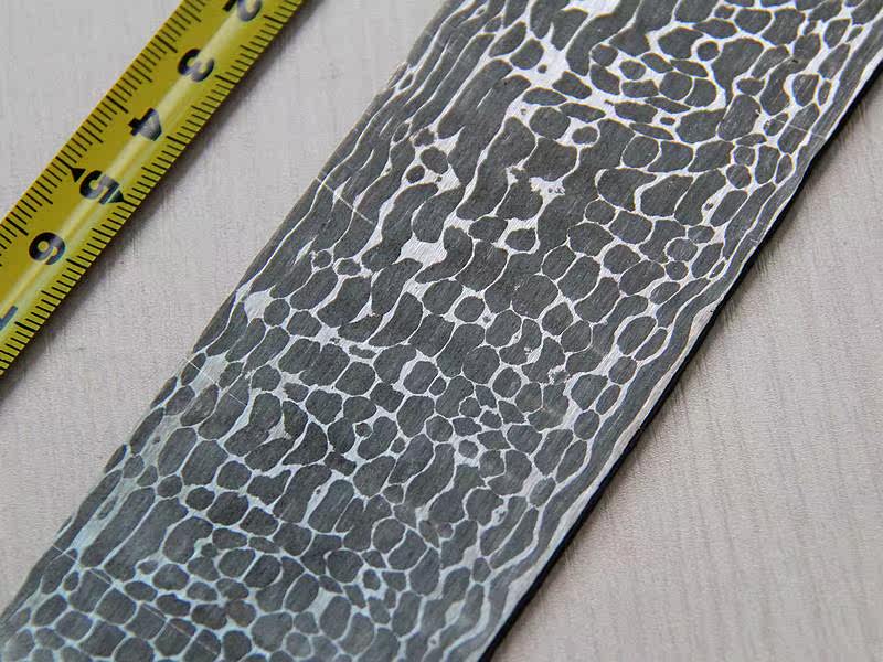

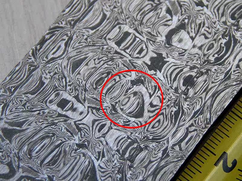

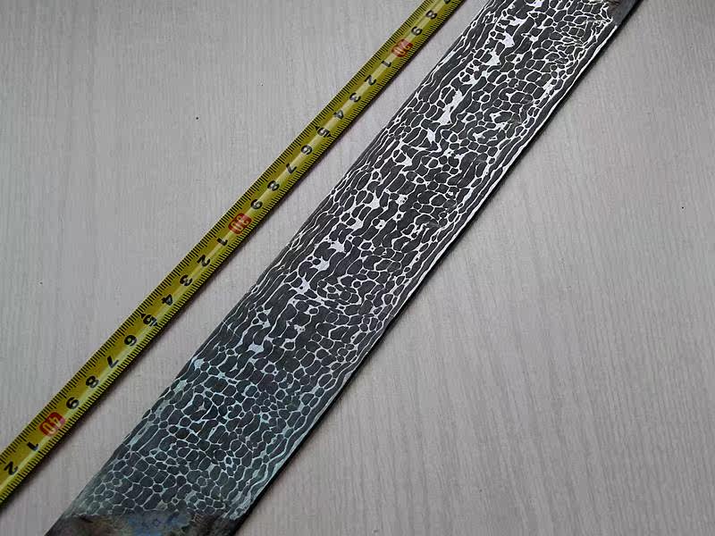

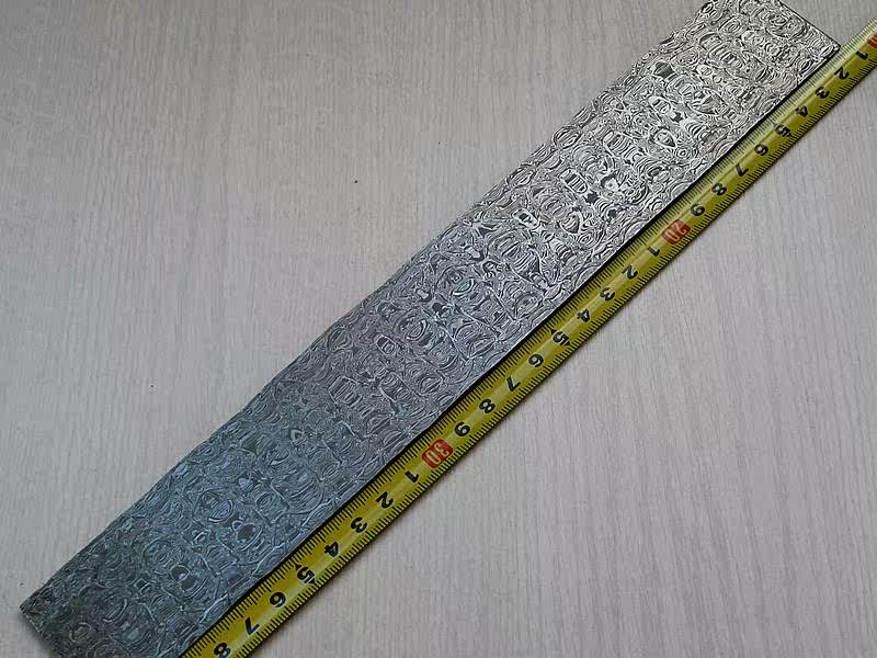

I''v made some stainless damascus steel
Jun 5, 2012
26
14Cr-4Mo is used as the bright colour steel, and 6Cr13 is uesd as the dark colour steel.
The chemical composition of 14Cr-4Mo by % is:
Carbon 1.0
Si 0.30
Mn 0.40
Cr 14.0
Mo 4.0
The chemical composition of 6Cr13 by % is:
Carbon 0.6
Si 0.30
Mn 0.45
Cr 13.5

I remember you from several years back. You are a metallurgist in China, IIRC. Good to see you back again. Did you ever start making knives yet?
Xie-xie for showing us what you made. How about showing us some photos of your equipment and tell us how you made the stainless damascus.
