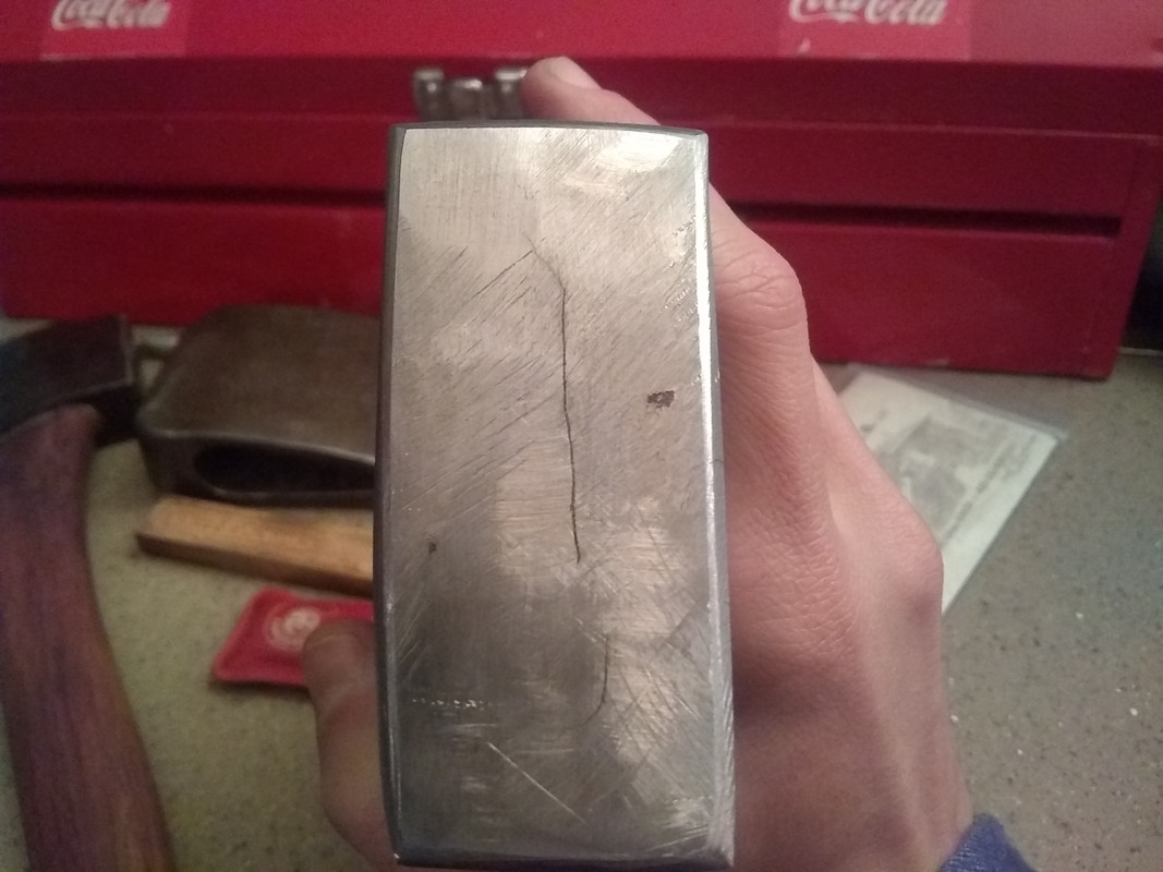

So I was flilng on the poll of that unidentified Dayton that belonged to my grandfather, and a couple cracks appeared that definitely weren't at all visible before this.
They seem superficial so I'm not worried, this is just a new one to me.
Has anyone ever encountered this before ?
"Has anyone ever encountered this before?"

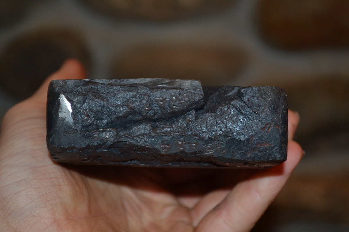

Yes. Mine was more severe, though.... Be careful as the poll didn't look that bad but this was hiding underneath. At some point I'll use a cutting torch to blow all that out and forge weld a hardened poll on it.
There's a hytest on eBay with a crack in the pole
Already sold but shows up on google search
The TT slasher i finished up about a month ago has similar cracks in the poll.
This axe had been beaten a fair amount though and had some mushrooming before i restored it. So I'm sure that is the cause of the cracks in mine. Was the poll on yours beat up?
Yes the poll was pretty beat up, it wasn't super mushroomed though.
