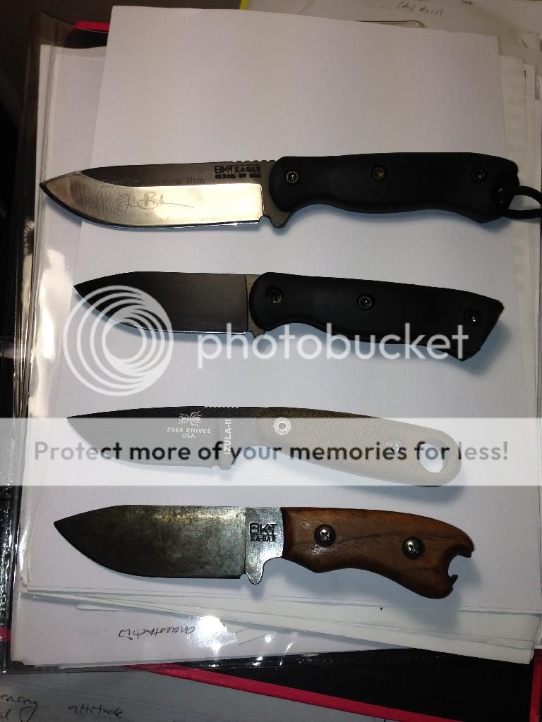

I've posted this before, so I'm sure many of you have already seen it. Like most in this thread I love my 14 but the Izula II handle is about a bazillion times more comfortable because it's longer, so I made a cedar handle for my 14 that is about 3/4" longer than the actual handle. All I did was cut a slot in the cedar block on my table saw, slid the handle in with some epoxy on it, and wa-la. A little sanding, some shaping, a couple of brass pins, some spar varnish, and a 14 that was amazing to hold and work with. I've thought for a while now that the lack of a smaller blade with a full sized handle was a hole in the Becker lineup.

More or less what I was thinking. Why not an Eskabar-2? Same blade but with the longer Izula-II handle. Might be nice. Factoring in blade and handle length it would be darn close in size to an ESEE-3.
I agree, don't grind the 16! Find a way to rig up the handle scales. Or, a Busse Scrapyard 3.11 comes to mind as an alternative...
Here is another variation for you, I would like to see tweener sized blades on full sized Becker handles. A 16 with a 2 handle would be awesome!

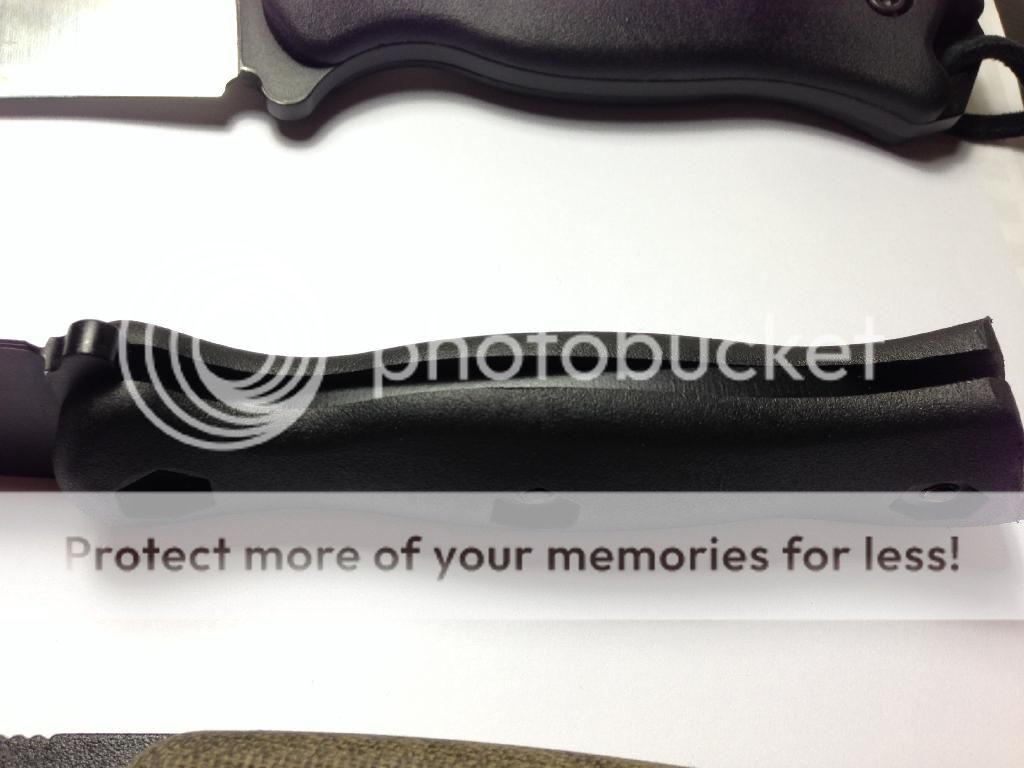

This thread intrigued me and so I had a go at mocking it up. I think the handles look pretty good on my eskabar, I just have no idea how to secure this properly. anyone have any ideas?
only the middle screw is through the body, I suppose I could size some wood in there to help with traction, Top hole is blocked by the knife, might have to fill it in, last screw is hanging freely.
would love to hear from the experienced DIYers cos I have no experience in this whatsoever
You could add filler wood or maybe even colored G10 for a super cool look--I would use epoxy to secure it if you're serious about not going back to stock.
