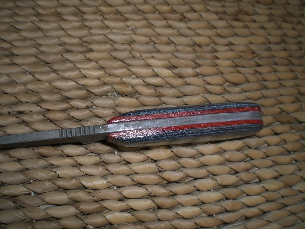

Just made a slab of micarta out of blue jeans and some orange canvas. I've just ruffed it in but would like to see how the rat community likes it. I would make it half the thickness next time but this is my first attempt.
[/IMG] side view showing the orange liner

Cool work, keep us updated on the finished results. I do think thinner is better but that's just my preference for the Izula.

I like the scales a lot, the only thing is it takes away from my favorite part of the izula and that is just how thin it is. It's all about ergonomics though and it would probably change my mind if I held it. Great work!

I think it's too wide also so I will sand it down to a better thickness. I used a slow drying epoxy and pressed it between two blocks at about 100 lbs. I will post later when I get them fit right now they are super glued to the handle which I taped with scotch tape first.
As I said it is my first attempt but I made enough for 4-5 Izula but might try to put them on my RC-6 too.
