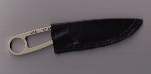

I've had some scraps of leather that is a bit thin and stretchy, but I tried out a simple sheath design (not one stitch is the same length as any other ... ouch).
I did form it with warm water, nearly dry now. If I could get it to be a little bit harder, it would actually work ... (but not look cool)

I thought of doing something like that. Did you consider dipping it in hot wax and forming it? Should turn the sheath hard.

Be careful how hot the wax is before dipping that sheath, if its too hot the leather will "cook" and shrivel up. You'll end up with a leather jalapeno. I'd use a low melt wax like beeswax or similar, and mix a little neatsfoot oil in, just a few drops will do.
If your not comfortable with wax you might try gluing several layers of the leather together with contact cement effectively making a stiffer sheath. That will cure the stretchiness as well.

I thought of carefully heating the sheath and melting some wax. I've got some beeswax.
as for glueing leather, I thought of that, but at the moment that little piece of leather is all I have. - Which also means I have to be extra careful with the heat.
By the way, the welt (hope its the right word, if it doesen't make sense: the small strip of leather that keeps the knife from cutting through the seam) fits great, I could punch a hole into the sheath and use it to carry the Izula upside down. That way, the softness wouldn't even bother me, but I just want to shove it into my pocket ...
OK. Not really fit to be shown, cause this is my very first attempt at making a leather sheath and it was more of testing the concept, stitched together in front of the screen. No photo, I just put it onto the scanner.
Very low profile, tight fit, and with hot wax treatment reasonably hard.
In fact the fit is so tight, I could really use it as a necker sheath.
Not a beauty though, but I think it is worth getting some better tools and suited leather.

Thats not bad at all! :D First sheaths are never pretty show pieces.
Welt is the correct term for the strip of leather that protects the blade from the stitches. :) Getting one to fit right is half the battle.
