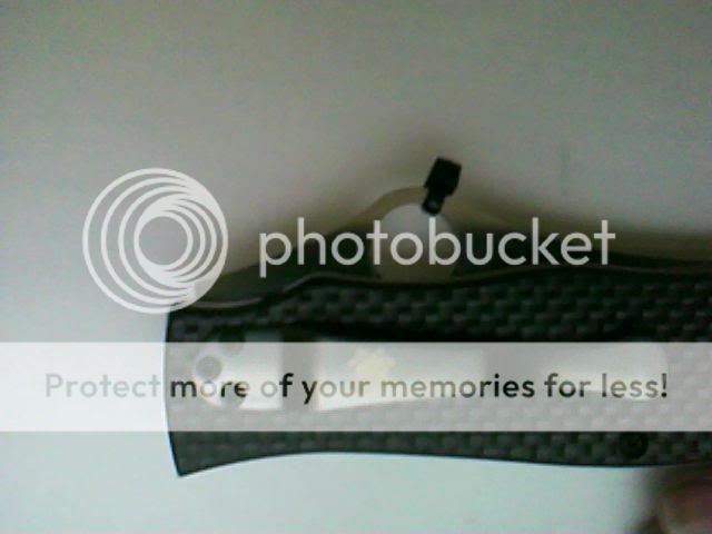

Can somebody post a picture of a zip-tie modification. Not sure if this qualifies for "Didn't happen without pics" or not but, I am not seeing this in my minds eye very well. I presume that the zip tie catches on the inside seam?
Hit us with a pic is somebody can. Thanks.

I'll get a pic up with my Spyderco in a few minutes.
EDIT: Here you go.

I honestly can't see the ziptie breaking off anytime soon. I usually cut it off and replace in a month or so when I oil the blade anyways. Also, with the Spyderhole(which is the only waved knife I have right now), I still have the option of opening it slowly, since I can still use the Spyderhole even with the ziptie installed. Also, I don't particularly like chisel grinds. I have nothing against them, it's just personal preference, and I don't want to send an Emerson out to get reground if I buy one.
