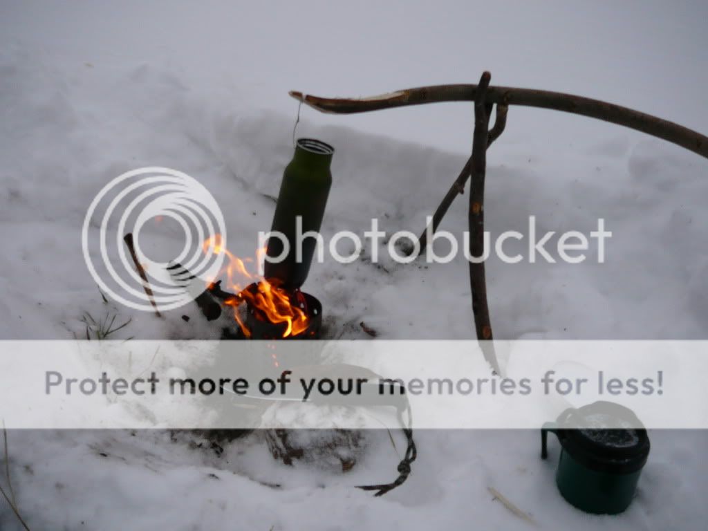

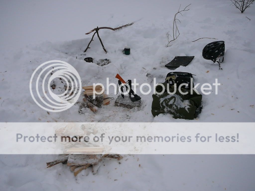

Some Testing:
Date: 23/12-10
temp.: -3C
40cm snow
Aim: Firemaking

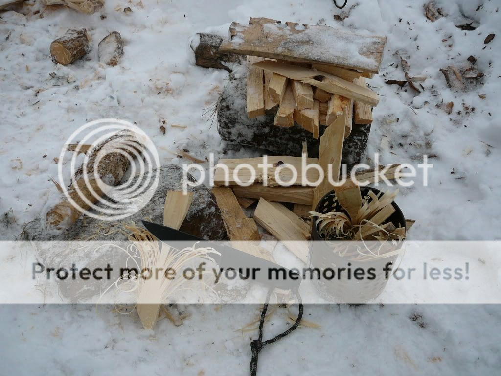

BATONING: The m07 did perfect but I had no thick, hard and knotty wood to baton. I could only some easy stuff. The m07 has good splitting thickness but will lack some length for splitting logs (make some wedges!).
CROSS GRAIN BATONING: No problem for the m07 but the relatively fat (5.3mm thick) blade is difficult to hammer through wood cross grain - e.g. the 2.5mm thick CS Bushman blast through wood in cross grain batoning.
CHOPPING: Tested the m07 against the ESEE4 and the m07 was way better due to better penetration and the handle of the m07 is perfect for chopping with partial grip and a lanyard around my wrist (Remember that this is still only a 198g heavy blade!). The m07 also chops better than the Cold Steel Bushman.
CARVING FEATHER STICKS:
The m07 is good at this! Better than my Enzo Trapper, Fallkniven F1, ESEE4, ESEE Izula, Becker Necker, Condor Bushcraft 4”. Only Frost Mora’s as always can beat the m07 in the carving tasks. (I do not show delicate feather sticks in the pics. The ones shown is some fast ones done with gloves on)

I bought the m07 today and went out for some testing in snowy conditions with a temperature of -3C. Along came the ESEE4 for reference as its quite similar (weight = 214g and length = 23cm). In general the m07 is compared to all the knives mentioned above.
The knife chopped a lot better than I had hoped for. I had already read somewhere that the m95 (which is 12g heavier, 2-3cm longer and has more forward weight) should chop out of its sized so my expectations was high.

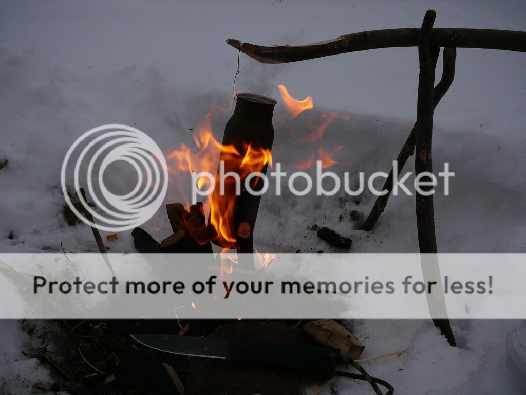

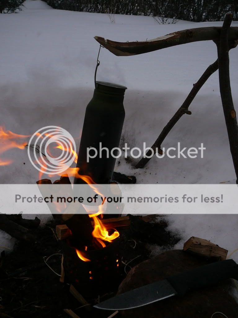

It work really great for burning half rotten and partly wet wood.
With a vaseline soaked cotten ball (or just birch bark, if you have that around) you can get a little fire going from otherwise NOT burnable wood - which means that you can save same weight on heavy wood processing tools (the new "content" / "ordning"= the swedish name weighs 130g ~ 3.4oz).
To optimized air flow: I usely dig a long mini trench which the IKEA content is placed on. If digging is not possible it can be placed on 3 small rocks.
The stainless bottle is a stanley 24oz.
