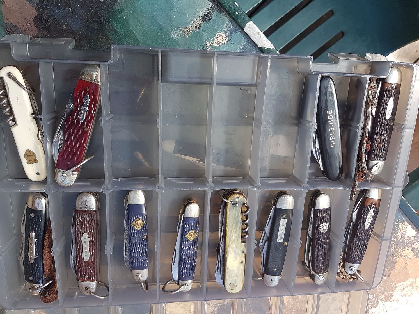

Thanks, Jack. My subtle and cunning plan has shifted a bit.
So here's a Stag of Ireland scout knife missing one shell handle. ( I have scout knives, but this is my first Irish Stag.)
I thought I might peel a handle off another shell handled scout knife. Unfortunately, these cheap shell-handled Imperials hold up very well, so I don't have one fit to be cannibalized.
I do have a Camillus scout so beat up I'm surprised to have bought it. I plan to drill and melt off a couple of bolsters from that, glue them to the Stag, and glue the shrinky-dink in between.
Two Imperials above; Jowika, project knife, parts knife below.

That's what I would do if it were missing both handles. Actually I once did that on a missing handle and left the shell handle on the other side. I can't find that one now, so it may be one of the three a guy managed to sell for me. (I consigned 34 to him, but they were the sort of things only I would buy. 31 of them are now in my parts bin where they belong.)
Because it's my only Stag, and because I'm lazy, I want to preserve the remaining handle and cobble together something that looks not too different for the missing one.

I've been distracted with a Basque makila- inspired spear stick, since I came across some coyote scat in the back yard, which is my excuse for not being further along with this.
I snipped the pin in the donor knife by slipping in a knife and squeezing it in a vice. Don't try this at home! Always wear safety glasses! I also stood in a forward tiger stance to protect my cruxial vitals, tucked in my chin to protect my throat, and threw a rag over the top to retard the flight of anything that might have gone ping-sproing.
Now I have to file the nubbins off the backs of the bolsters and relieve them to receive the raised pins on the donee liners.
