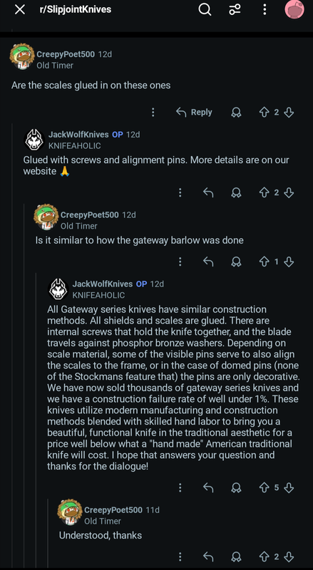

Did some investigation and came up with more than I expected...
This on Instagram:
...comments that followed were - Sadly long thread of comments with Ben (owner JWK) chipping in, he doesn’t deny but rather explains (cost cutting).
Also another comment, suggesting - I lost interest in their knives when I learnt they were expecting suppliers to take losses, when they had sent a knife out with issues. I thought if they treat suppliers like that…..
Confess, am now rather disappointed given the supposed total 'genuine' thrust given in Ben's marketing, then, and now.
The world of slipjoint enthusiasts is still strongest in USA...........who is possibly attempting to kid who here 🤔
No intent of malice here, just seeking the truth.
(if inappropriate, please delete or move elsewhere)

I just read the instagram thread you posted. Really crazy stuff! I've never heard of decorative pins, but I guess it's a thing.

Just a question, are we sure the pins are just domed for looks? I see the small divots where the pins would hit the frame, are the pins supposed to go through the frame? Just wanted more thoughts before I decide to NOT get one. Excuse my lack of knowledge in construction of such folders.
The maker seems to have said they were just for looks, so, yeah....
If you look close you can see marks from assembly on the frame around those divots.

Saw this on another forum
Personally, I'm not a fan of handle covers that are only glued on, but Case and Buck both sell knives with glued on handles, usually with premium prices as well. At least they don't have fake pins on those.
I find pins that imitate a pinned construction handle to be weird.
Seems deceptive, but knife companies have been doing similar things for many decades. Old Timers had the Swindon key construction, and I think the Colonial Ranger series had some sort of similar thing going on. And of course the stamped-out hollow shell handles on Colonial, Imperial, Ideal, and others - which are less deceptive, I think though, because more obviously fake.
Still, whoever in China makes the RR, Marbles, Frost, etc. knives does a good job of producing an affordable product with traditional pinned construction, so the talent exists there. Why not use it, instead of doing something that will risk destroying your reputation?
Anyway, I’m glad I decided not to buy the equal-end jack.

Wondering how fake the non domed pins are. Seems like they’re for “alignment” so maybe they lock into those dimples in the liners. Real bummer to see the corners they are cutting on these. Really wish they’d just used functional pins. Taking a thing I really liked and putting a bad taste in my mouth. If Rough Rider can do it…
Pins in traditional knives are to hold the knife together, not for “alignment.” You can align a glued cover w/o pins.
To me, the fake pins are deceptive not “aesthetic.” Just because Jack Wolf discloses the fake pins on their website doesn’t make it right.
Concerning disclosure, a quick check of their website shows a fixed blade disclosed as being “Construction: Glued with Alignment Pins” but this is not disclosed for a slip joint. I checked two retailers and there was no disclosure for both fixed blades and slipjoints.
Why go to the trouble of faking pinned construction?
