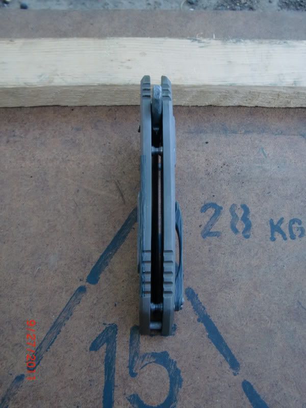

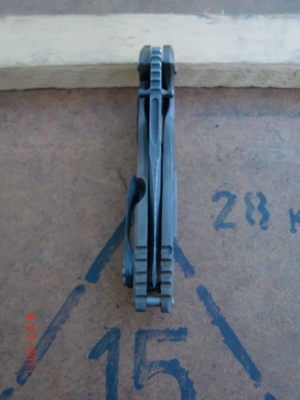

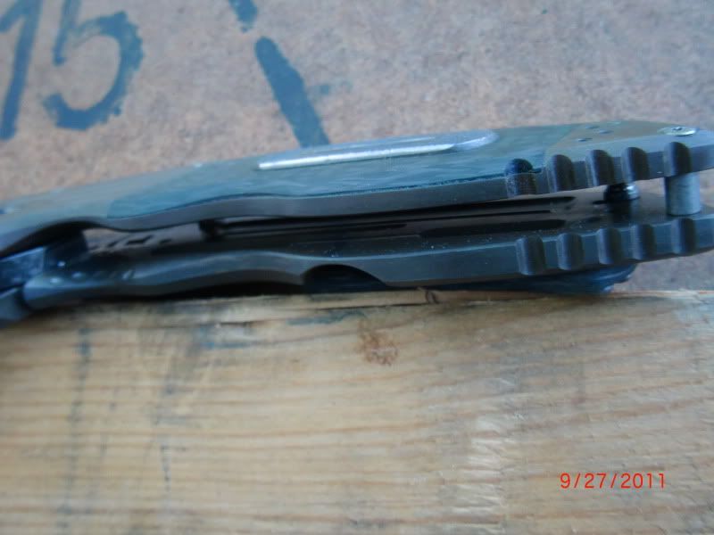

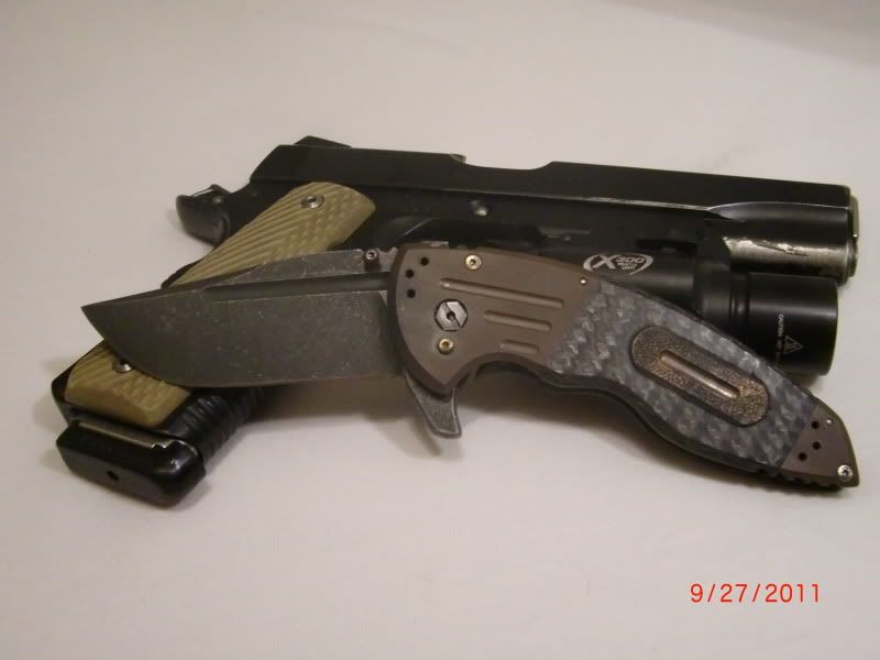

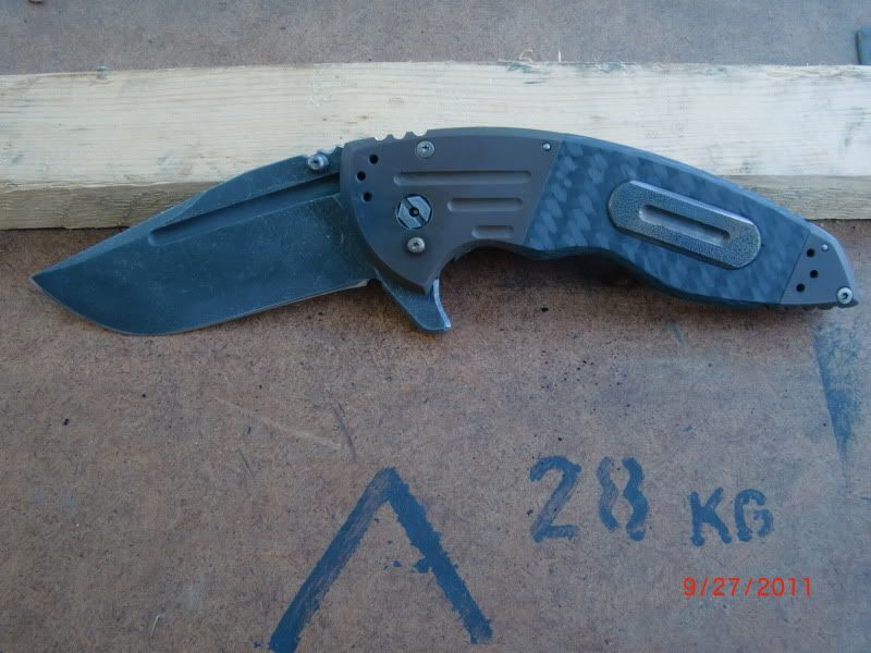

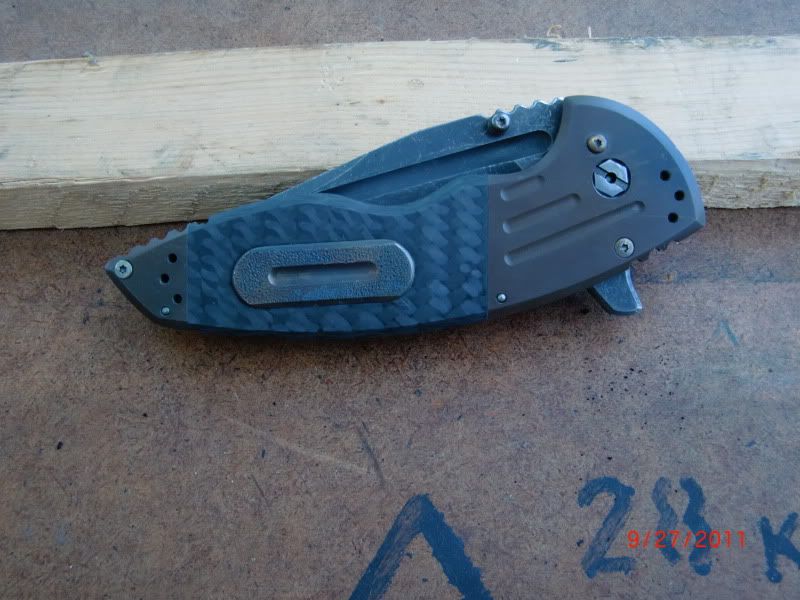

Just got this finished up on the side of other orders, figured I would post some pics. Hope yall like it.
Specs:
.200 thick titanium slabs, lock side is solid titanium milled out to lightly press fit carbon fiber, titanium inlay in carbon holds carbon to frame slab is also press fit, it is also epoxied in just in case!
.200 thick CPM154CM blade
Carbon fiber clip
heat ano frames:eeek: I thought they turned out sweet! too bad my pics suck!!! I didn't realize they looked blue
I'll get more pics in the sun, it is a very nice brown
little better pics
Lightened the non-lock side so it weights the same as the lockside
Trit in the pivot hole
