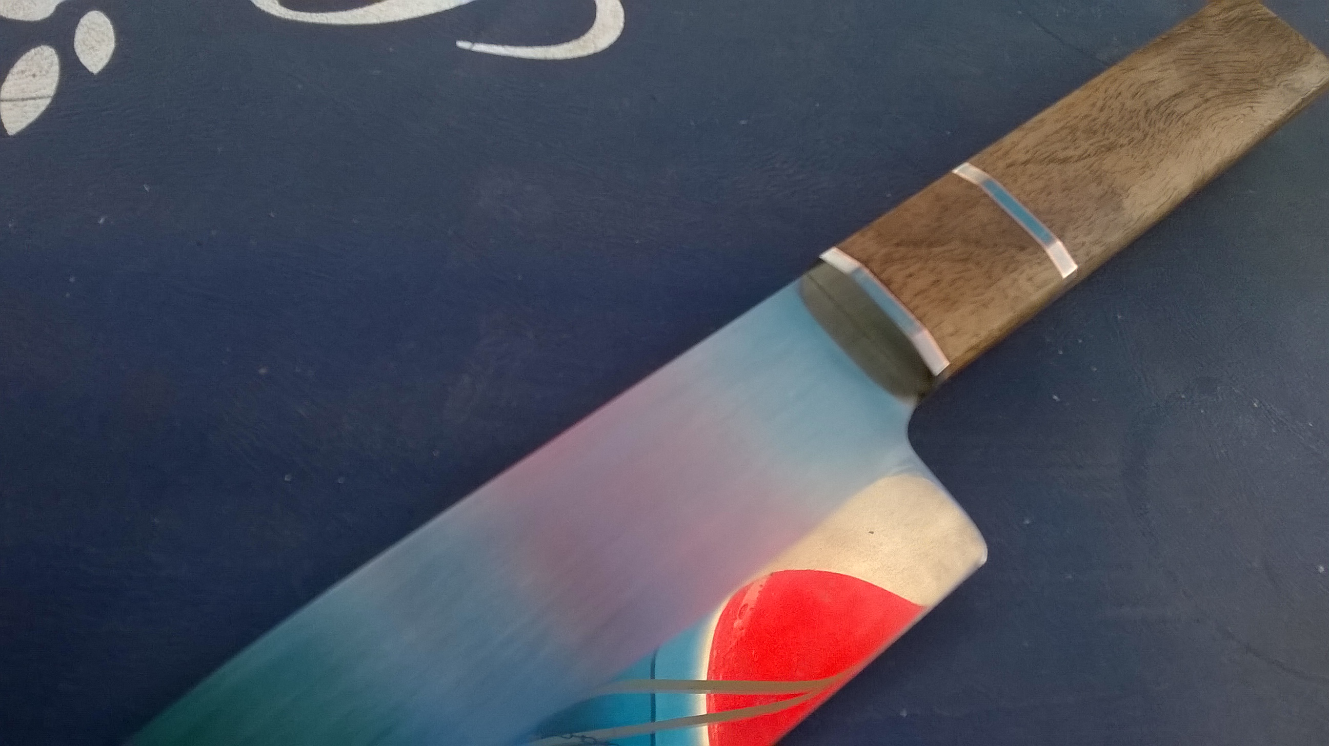

Why not do that on disk sander? Take a minute to do that ? Just set the angle of rest/work/plate .This one have 12 corners :D
