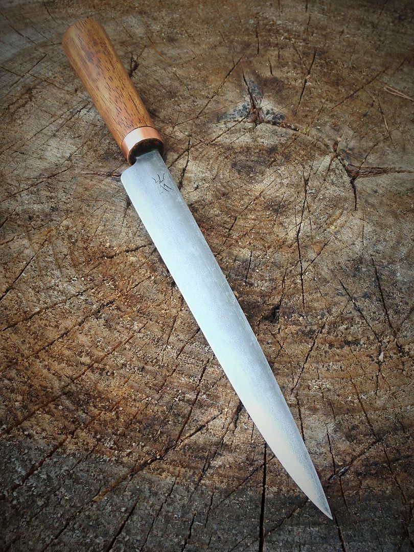

52100, forged from 1" round bar. Skinny for the winny.

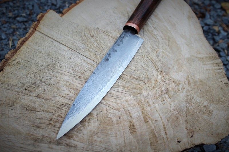

forged from 1 inch W2 round. S grind.

My version is a two facet flat grind with a very shallow hollow ground in the middle right under the "pseudo shinogi line' and a convex lower 3/8 of an inch or so with everything thinned out and blended together.
JDM what's an "S" grind? That one's new to me.

For a full size chef knife, (1/8 inch with good taper) I would not go any thinner personally. The thickness he is likely talking about is behind the edge. It should be only .004 to .005 behind the edge before you sharpen. The s grind I have used actually hollows out the area behind the edge to further thin the geometry. I don't recall using or seeing a Japanese kitchen knife with a convex grind behind the edge. The convexity usually is from the shinogi (sp) line or a bit above toward the top of the spine. This forms the backward "S" grind where the spine is slightly thinner than the middle of the blade and the area below that is hollowed out a bit and the edge is the thinnest part. This grind is usually only on the bevel that is away from the chef's body to increase food release, the bevel closest to the body is usually closer to a full flat grind or can actually be flat with a concave bevel such as in single bevel Japanese knives.
This grind is very different than a "convex" grind that you would have on a bowie or an ABS testing blade.
